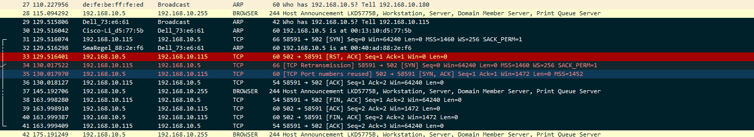

Update: Used Wireshark to capture traffic between
Arduino IP : 192.168.10.180
Inverter IP : 192.168.10.5
PC IP : 192.168.10.115
  1. inverter and PC during a successful Telnet :port 502 attempt
After the ARP discovery , a TCP connection is established
and..
  1. inverter and arduino during a failed connect attempt
In this case after the ARP discovery, nothing happens.
Any ideas why ?
PS: Sorry for the small picture size.
Yes, but you have a double answer to the ARP request. You have two devices that claim to have the IP 192.168.10.5, one of them seems to be a Cisco Linksys device (the other probably your inverter), that may help you find the reason for your problems.

UPDATE:
There was indeed an IP conflict in the network which caused all the problems.
Problem now solved.
