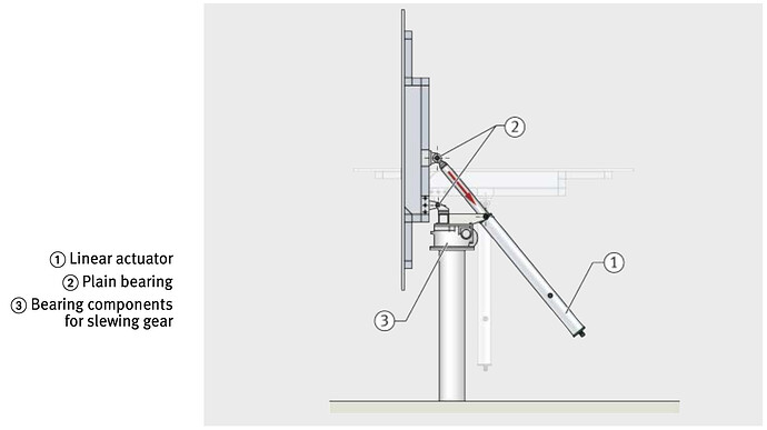

I need to rotate a 7,5kg solar tracker assembly, and am wondering which motor speed reduction ratio would be suitable. There are many worm drive gears on offer, from 5:1 to 100:1, and probably other ratios, too. Another question would be if a brushed DC motor or DC stepper motor should be used. Basic principle below, it's about component (3).
Thanks!

Why not use a second linear actuator? If you have the actuators with feedback, your program could compute the position of the assembly.

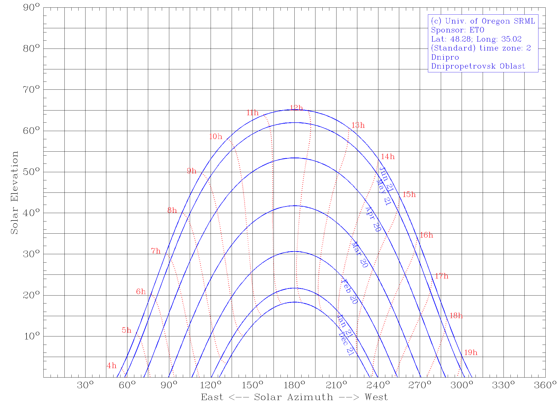

A program reliably calculates the sun's path, see below, and there is an Arduino library for that; but I based the solar tracker on the principle with one linear actuator shown above. The rotation scheme, night return and storm parking is to be based on an on/off schedule. Ideally, I want to compare near real-time vs. every hour tracking output, so the brushed DC motor or DC stepper motor reduction ratio needs to be suitable for both.

For component 3 (azimuth rotation), a stepper motor is ideal. If the support is horizontal, the rotary table needs only to be aligned once to North (0 degrees, for example), and then calculate the number of steps to orient the assembly to any other azimuth.

Well, the motors I saw have encoders, just like the linear actuators. The question rather is which type of motor and what reduction ratio. Some researchers suggest a low ratio. Some researchers suggest a high ratio. For me, it is hard to judge who is right, or if it maybe doesn't even matter.

So, you are using a ratio of 5:1. I have to contend with some wind and turbulence flutter. Do you think your geared solution based on a stepper motor, scaled up, would hold radial and axial loads as well as a worm geared solution?
The radial and axial loads must be taken up by the bearing (use a thrust bearing).
The stepper would ideally be connected to a worm drive gear on the rotating shaft and bear no load.
I recommend going with the highest ratio you can that still allows you to move at the speed required. That'll reduce the torque required by your motor to a minimum. You'll have an easier time overcoming wind forces as well. The downside is that the motor will need to rotate for a longer period of time, but also at a reduced torque. How sensitive is your energy budget?

The azimuth speed, if the solar tracker were to follow the sun in real-time, would be 15° per hour so 0,000072721944444 rad/s. Regarding the energy budget, what I know is that the annual DNI is at best 1300 kWh/m2 (daily 3.6 kWh/m2), and the already donated 12V 100W rugged ETFE PV modules are 0.65 m2 and weigh 2.8kg.

For positioning a solar panel, in full sun a few degrees of orientation error makes no significant difference in output.
