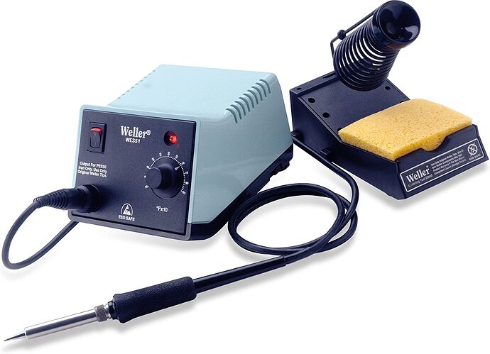

This is a good one:

I've done a lot of soldering, and gone through literally dozens of irons. The one I've been most happy with and has treated me the best is a weller WESD51, (similar to the one florinc posted, I just have the digital version of it). I'm convinced you cannot go wrong with either the analog or digital version of this iron. The tip is pre-treated so you will never have to use any sort of 'tip tinner' or tip refinishing stuff, and you'll actually want to stay away from that as once you use the stuff it can ruin certain tips.
The irons seem expensive, but they heat up quickly (60-90 seconds), heat stays consistent from soldering, to using the sponge, back to soldering.
Whatever you do get, just keep in mind that you need to maintain even industrial type irons, remove the tip once in a while and clean the crud off it, sometimes even on good irons the tip will seize to the heating element.
Great, thanks for your help. Still making up my mind, but the analog WES51 is looking like a good bet right about now.

I have the WES51 and it's a great iron. The WESD51 is identical except the D has a digital display of the temperature. You have to have a decent iron even just for assembling perf board.
I think the only reason the radio shack crap exists is to fool newbies into thinking soldering is difficult and tedious. With a good iron it's a pleasure.
