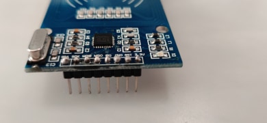

Hi guys. I can't any reaction out of RFID chip
I soldered my RFID RC522 yesterday.
On my first Attempt it ended up like Pic1
I was told to re-do it and the second (and current) version looks like Pic2
I did NOT plug the RC522 before i reached Pic2
Now.. I tried running the "DumpInfo" example and connected the pins as it says but still no reaction..
Can someone point me in the right direction? Is it firmware, soldering or something else maybe?

Could be anything, you have provided precious little detail.
  1. Soldering still looks wrong on picture 2, but the angle is not the best for looking at it. The balls high up the pin suggest that it is not making proper contact with the PCB tracks.
  2. What Arduino are you using?
  3. How are you connecting this to the Arduino?
Typical problem is using a 5V Arduino on a 3V3 board like this with no level shifting.
Good news, bad news.
The bad news is that this is a terrible soldering job. The iron is too cold and there is way too much solder. It appears that three of the blobs are shorted to its neighbor.
The good news is that the board itself is probably OK. just heat up each pin and shake, suck or wick off the excess solder.
On further thought, unless you are proficient at soldering, you are likely going to damage the board with the wick.
The pictures also show no flux residue, so flux was not used in the soldering operation. It is a MUST to clean the metal and protect the molten solder from oxidation.

I think that I would be putting money on it! I can see shorted as well as dry joints. Sort that out and I reckon it will work. You need a hot iron, 60/40 Leaded solder and some practice. Don't be tempted by lead free solder until you are far more experienced.

From pictures 2 its visible there are sold solder joints. But why did you have to be told to redo the solder in picture 1 when you can see the pins are shorted together.
