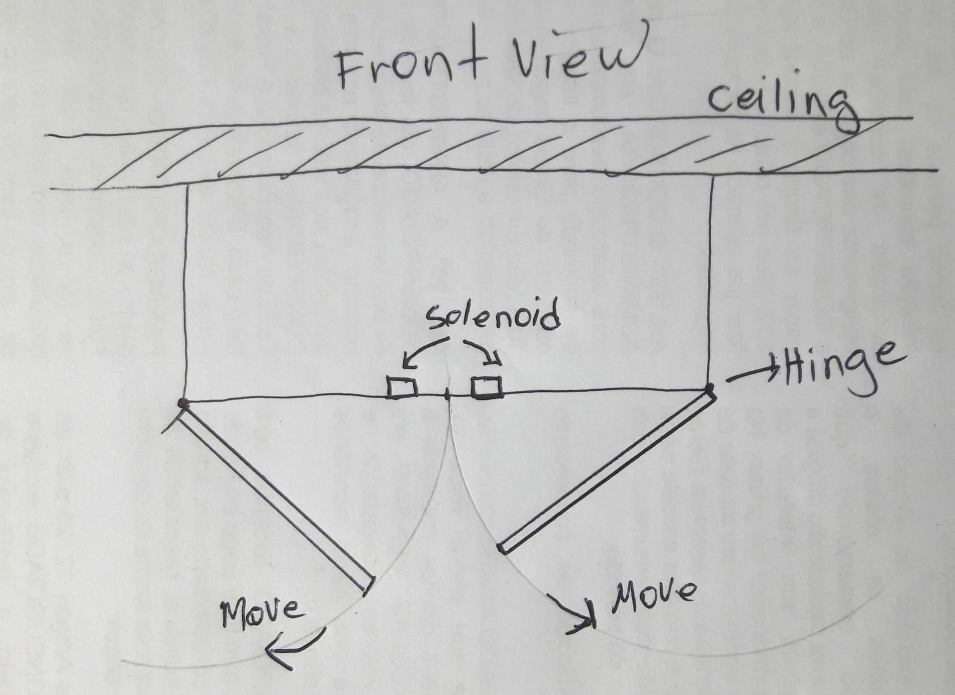

Solenoid opening a ceiling door
Hi everyone:)

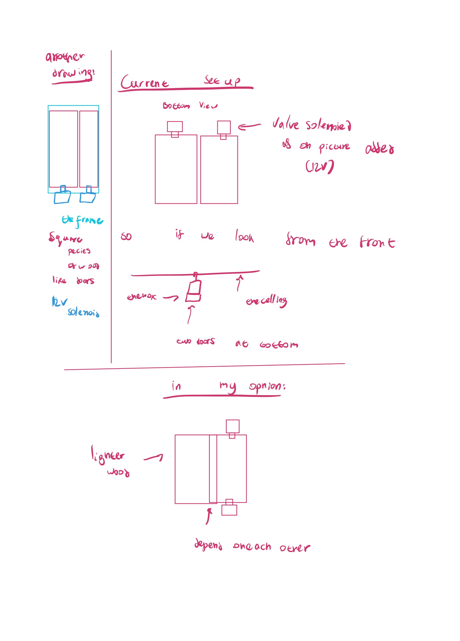

I am building a box with two doors like a closet.
I will be hanged from the ceiling.
I put 2 solenoid valves on each part of the 2 parts door, so that on cue the doors will open.
But the weight of the wood is too heavy for the 12v solenoid.
My options are, building a thinner door, a smaller one, or upgrading my solenoid.. many people suggest to change the mechanism, any advice?
First I think I will make two doors depend on one door, and then put solenoid on each side, instead of one for each..
thanks a lot in advance hope it was clear
Some pics could help us to understand your problem.
From what I can understand a linear actuator could solve the problem.

It's something like this?
sounds like we need a servo controlled winch..
couple pulleys, some rope..
yummy,yummy.. :slight_smile:
It could solve the problem.
Exactly! amazing sketch :slight_smile:

Keep in mind that the magnet won't replace the solenoid because if lacks energy the doors will open.
The magnet will pull the doors to release the pressure over the latch.
oh wow!
but why would the magnet lack energy? it is a good idea to use both..
