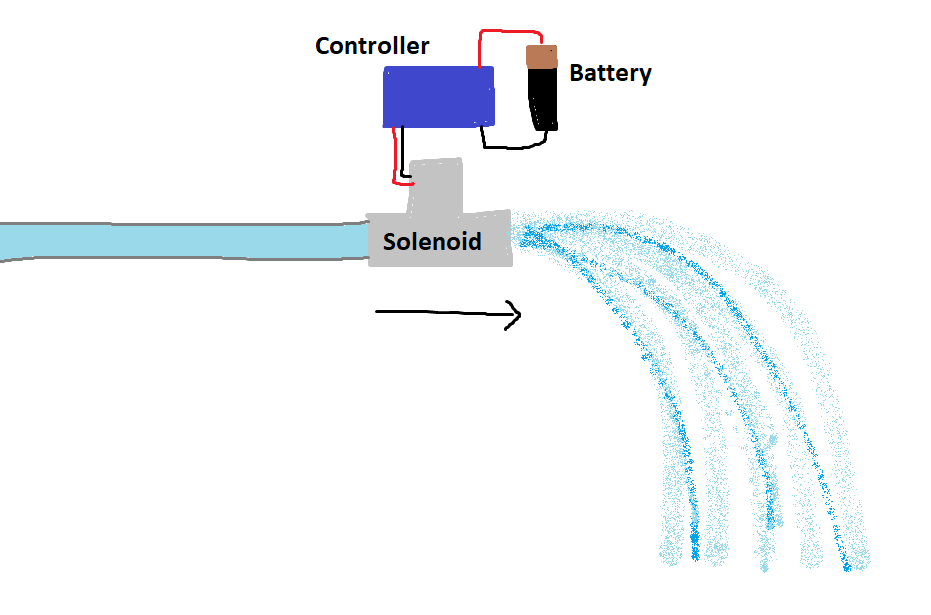

I am using an Arduino setup to water my garden using a bistable/latching solenoid valve and batteries. My setup works flawless and has no problem but I'm concern about a certain scenario where the valve is kept open forever. The bistable needs a trigger from a motor controller to open and to close. In a worst case scenario, the valve opens and there could be any power failure then the solenoid will be kept open and the water keeps flowing. A regular solenoid valve will gets closed in case of a power failure but bistable solenoid valve is tricky and won't close until a logic trigger is needed. I don't know how to start or if a hardware or a software to fix it.
My project is using an Arduino Nano, MX1508 controller, 3xAA batteries and a Bistable solenoid valve.
Please advice and help me fix this potential failure.

In fail safe systems they use valves that are default closed and use (constant) power to stay open. If the power fails they will close automatically. Drawback is it can drain batteries.
You might be able to sense if the valve is open or closed by reading the pressure in the line. It should be lower when there is flow.
Then you'd need another valve in-line in case the main one fails.
But that's not as fail-safe as what robtillaart suggests.
That's the nature of bistable valve, there's no default state.

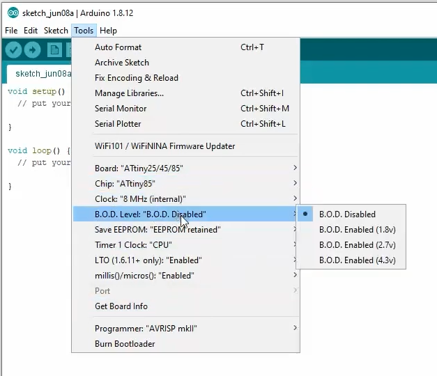

Extra components is not a problem, I just wanted to know if it's possible to do it any extra components, like having an internal under voltage sense or something. Because I see an option inside the Arduino IDE and has BOD drop down fir Microcore library.

Is it possible to detect B.O.D without external components? I see this option inside Arduino IDE
That is the level where the processor will reset.
You really need an external circuit to measure the battery voltage with at least a +/- 0.1V accuracy.
