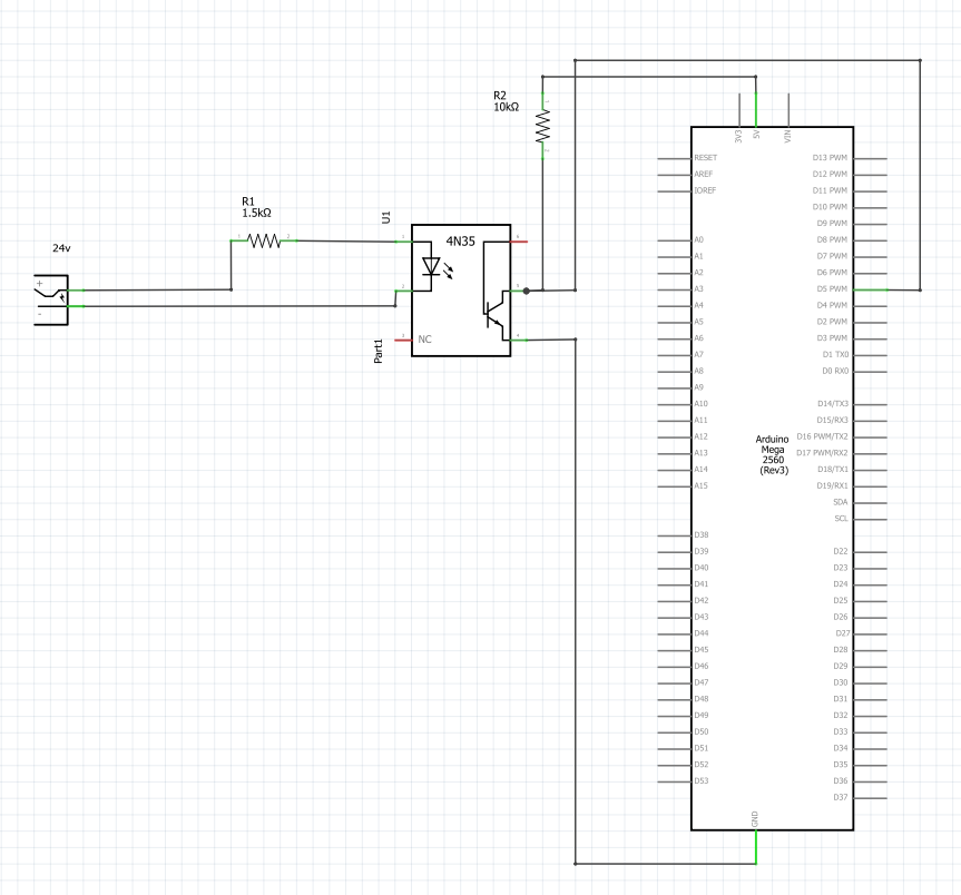

Would something like in the attachment works, or I need to get a 5v VCC on the transistor side of the octocoupler?
Would be better to use pull-up resistor. (Add ~ 10k from ATmega pin to Vcc)
helderferreira:
My understanding of an optocoupler is that you use as input, whatever you have- that's the whole idea. You need to check that your resistor on the input consumes enough voltage to get down to what's acceptable to the LED inside there, that's all. The data sheet will show it's characteristics, but it's just an LED.

I revised it to this using a 10k resistor between 5v VCC and transistor colector pin
is it correct now?
Yes.

My first response said to use the internal pullup, it's much easier...
It's also solution but 10k ensure higher current and better signal/noise.
Internal pull-up may vary according the datasheet is 20-50kohm.
