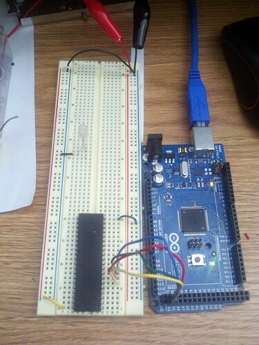

Ok, so I got that sorted out (kinda… it works for now :P). I want to give this another shot, but I’m going to start fresh and make no assumption that I have any idea what I’m doing here. The information I’m going off of originated from http://www.instructables.com/id/How-to-use-Arduino-Mega-2560-as-Arduino-isp/ and http://arduino.cc/en/Tutorial/ArduinoToBreadboard, neither of which actually discusses programming to the 8515, but I’m assuming that the information is still applicable other than pin assignments on the microcontroller itself. My information regarding the 8515 is coming from the project manual for the project I’m actually building
Manual:
http://www.reinerziegler.de/GB-Flasher/gbcflsh_manual.pdf
Schematic:
http://www.reinerziegler.de/GB-Flasher/schem+pcb/GB%20Cart%20Flasher%20(USB).pdf
Ok, so with all of that info, I’ve attached a picture to show what my board setup looks like (the LED is just a leftover from some other stuff I was working on…)
One thing I’ve been wondering is, do I need the 100uF cap across RST->GND on the Arduino to prevent auto-reset like I’ve read several places or is that not an issue? Do I need the external crystal while flashing or can I do it this way? Basically, I just want to make sure there are no errors in my hookup before continuing to hunt down the problem on the software side.
GNDs need to be connected.
Is the target powered close to 5 volts?
One thing I've been wondering is, do I need the 100uF cap across RST->GND on the Arduino to prevent auto-reset like I've read several places?
Yes.
If the target will be running from an external crystal then you will need to connect the external crystal while flashing.
Which GND's? Do I nee to connect the Arduino's GND to the breadboard GND?
The breadboard supply line is connected to an external 5v 1000mA source.
It will be. So I take it that I should be following more closely to the first scenario on the arduino.cc ArduinoToBreadboard guide for breadboard setup, rather than the barebones setup I have now? If so, do I need the capacitors as well and how do I figure out which pins on the 8515 I should be wiring this stuff up to? I'm assuming from the project wiring schematic that the crystal goes between pins 18 and 19, but I have no idea for the capacitors.
qwertymodo: Which GND's? Do I nee to connect the Arduino's GND to the breadboard GND?
Yes.
Perfect.
At the point you change the fuses so the processor runs from the external crystal you will have to have the crystal connected. Until then you can play with the target without connecting the external crystal. The processor leaves the factory ready-to-run.
If you are using a crystal then yes. If you are using a resonator then the capacitors are built-in.
Datasheet. The crystal or resonator is connected across XTAL1 and XTAL2 (physical pins 18 and 19).
The capacitors are connected from the pin to GND.
