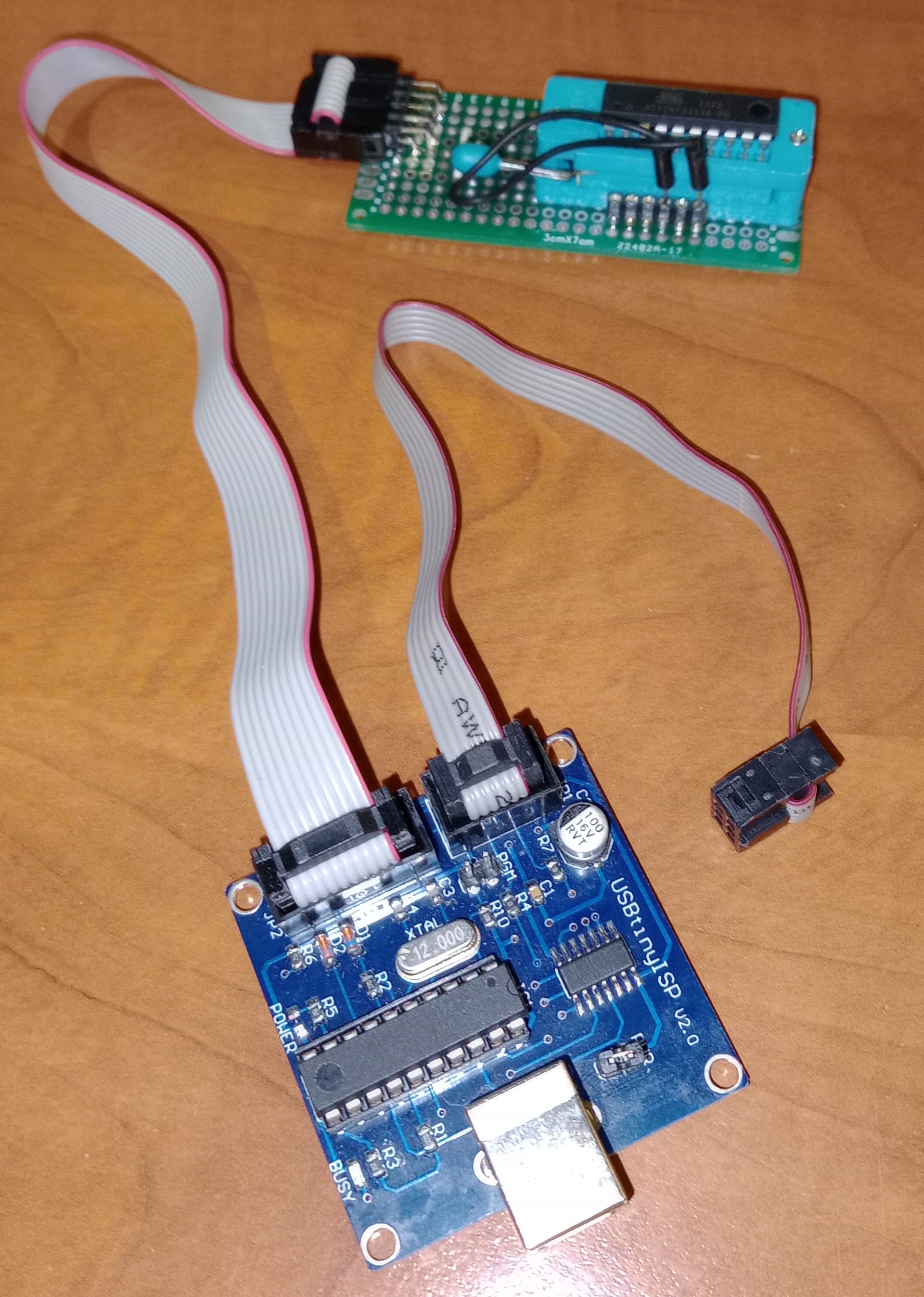

I used this antique USBTinyISP programmer based on a Attiny2313. The ZIF socket is homemade and can have ATTiny85, Attiny13 and Attiny2313.
I hardly ever use it and the processor gets quite hot when it is on for some time. I always use USBASP sticks.

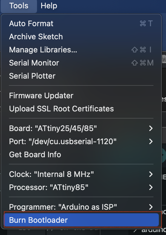

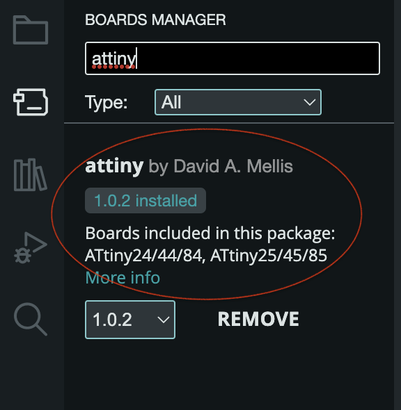

Hi to everyone !
I resolve my problem.
I got it!

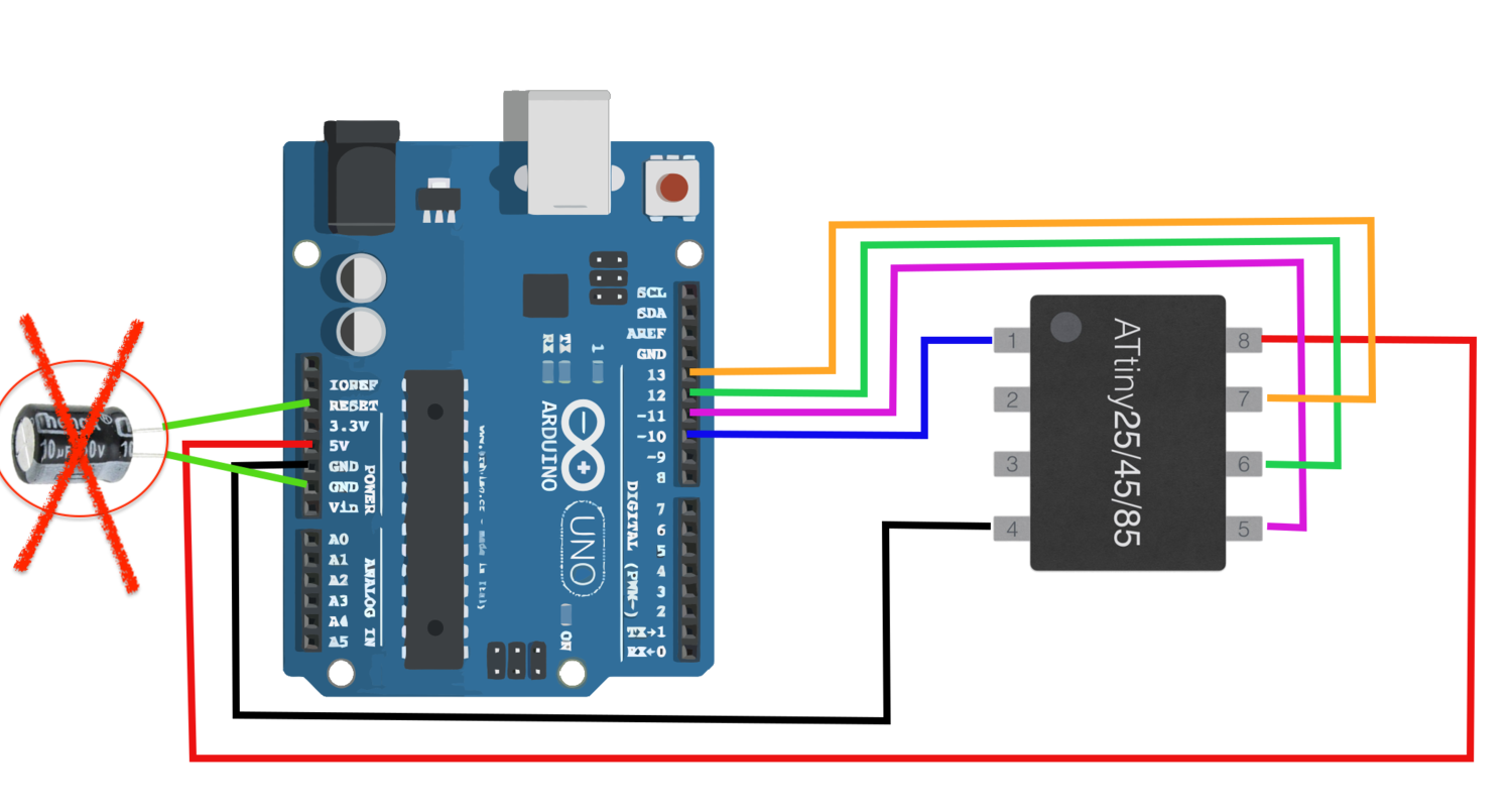

The mistake was "electrolytic capacitor" that I keep it onto my Arduino UNO board.
This capacitor shouldn't be here when you need to "prepare" the Arduino for the fist time by uploading the ISP sketch to it.
attiny_programming_w_arduino_uno 2
So, the reason of this "error" was my Arduino UNO that wasn't be prepared correctly before.
So here is how to do exactly :
1- Before all = > Prepare your Arduino UNO to be able to flash Attiny85.
Attention, Arduino UNO "reset" pin have to be without any capacitor.

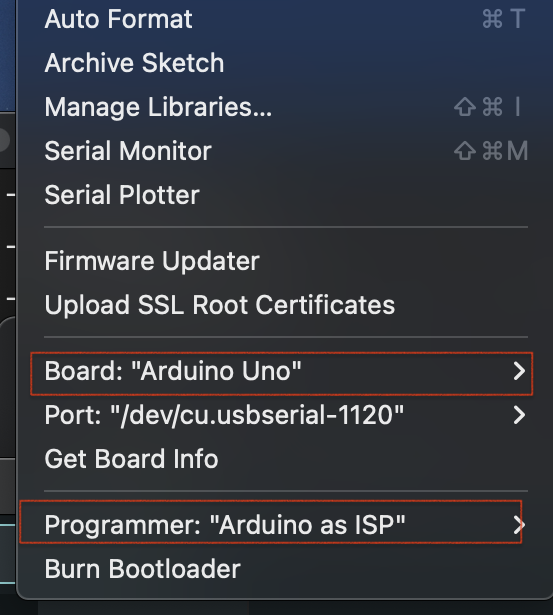

  • Go and select: Tools/Board/Arduino AVR boars/Arduino UNO
  • Go and select: Tools/Board/ Programmer/Arduino as ISP

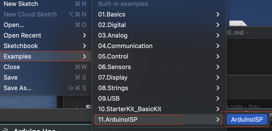

  • Go and select: File/Exemples/11.ArduinolSP/ArduinoISP

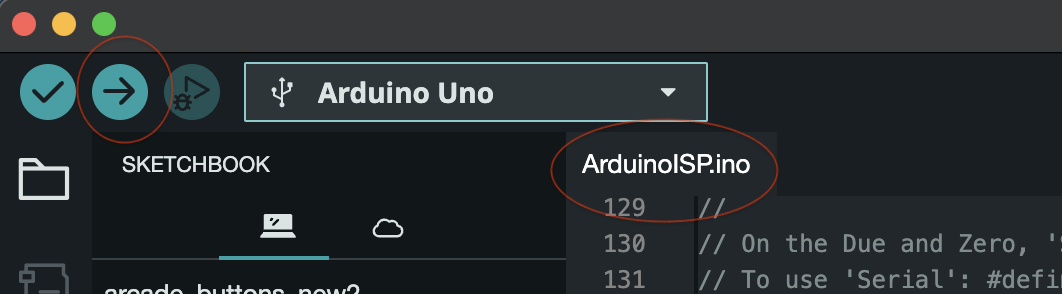

  • Upload ArduinoISP Exemple Code by clicking to "upload" button
Capture d’écran 2023-11-11 à 22 34 19
Done! Arduino are almost ready.
Now you can configure your Arduino UNO pinout for flashing Attiny85.

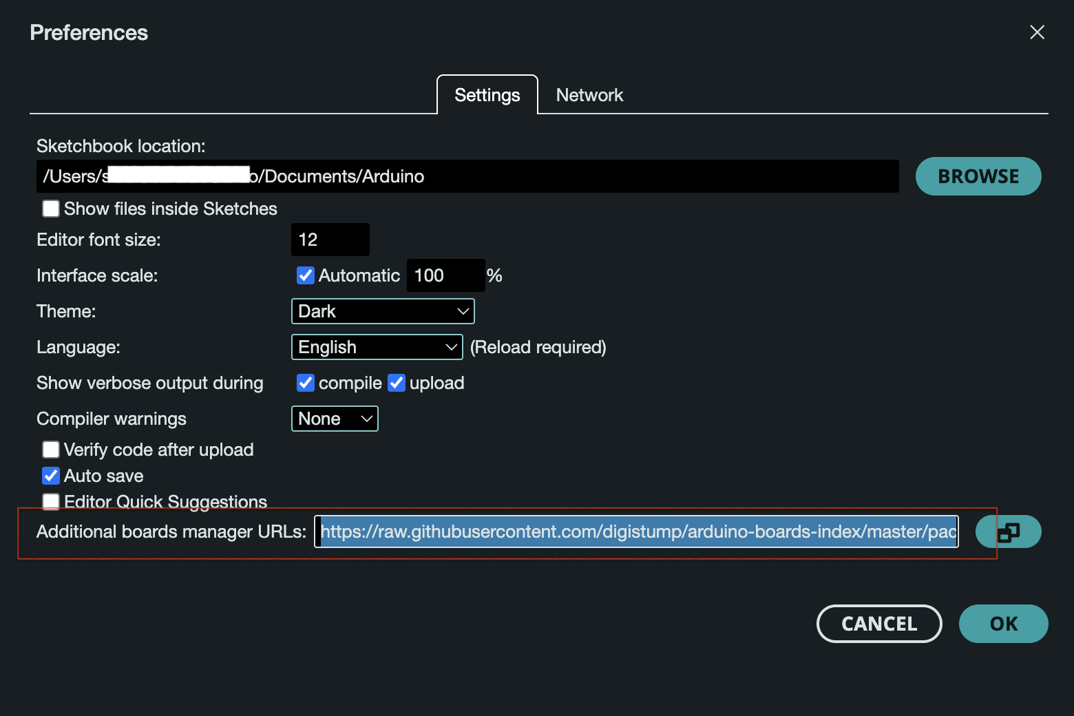

2 - Install Attiny boards manager by David A. Mellis
Capture d’écran 2023-11-11 à 22 36 51
  • Go to : Tools/Board/Boards Manager/
  • in search line type "attiny" and find "attiny by David A. Mellisby"
Capture d’écran 2023-11-11 à 22 35 48
  • Install it

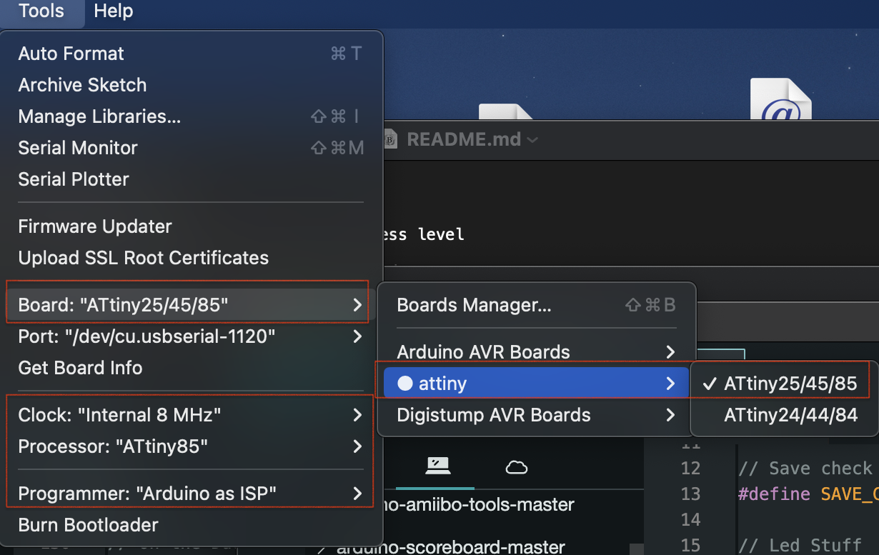

3-Prepare Arduino UNO to flash Attiny85:
  • Go and select : Tools/Board/attiny/ATtiny25/45/85
  • Go and select : Tools/Clock: "Internal 8 MHz"
  • Go and select : Tools/Processor: "ATtiny85"
  • Go and select : Tools/Programmer: "Arduino as ISP"
Capture d’écran 2023-11-11 à 22 38 56
  • Go to : Tools/Burn Bootloader
Capture d’écran 2023-11-11 à 22 42 03

  • Go and select : Tools/Burn Bootloader
  • Open sketch (if it not done before).
  • Go to "Sketch" and select "Upload Using Programmer"
