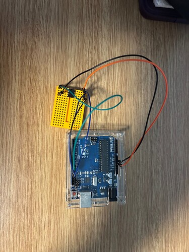

I have attempted to programme my ATTiny 85 with Arduino and it is not working.
I have done the following:
Downloaded and installed the ATTiny boards by David A. Mellis
Uploaded the ArduinoISP sketch – compiled and uploaded fine.
I connected up the ATTiny 85 as follows:
Arduino pin ATTiny 85 Pin
5V Pin 8
GND Pin 4
Pin 13 Pin 7
Pin 12 Pin 6
Pin 11 Pin 5
Pin 10 Pin 1
Opened up the Blink sketch changed to Digital Pin 0 from LED_BUILTIN
Changed programmer to Arduino as ISP
Uploaded Blink sketch – compiled and uploaded fine.
Connected LED up to digital pin 0 – Nothing.
Stripped and wired up ATTiny 85 with LED – Nothing.
Even without the ATTiny 85 connected the Blink sketch compiles and uploads fine
Tried to upload sketch without ATTiny 85 connected just to check – no issues
Tried to burn bootloader, error, see below:
avrdude: Error: Could not find USBtiny device (0x2341/0x49)
Failed chip erase: uploading error: exit status 1
I cannot figure out what I am doing wrong, any help would be much appreciated

The most probable cause of this is wrong or unreliable connection.
Could you show the photo of your setup?
I've had good luck using the USBasp board. It is not clear what programming board you are trying to use.
This is my setup, I though my programming board would work from the USB but it turns out I need to to the same in terms of wiring so thought I'd dispense with the board.
I have tried new jumpers and still get the same error message! Also, the breadboard is new.
You need a 100nF capacitor across the power pins of the ATtiny85 and as close as possible to the chip itself. This is not shown in your picture and may not be your only problem.

You do know physical pin5 is actually pin 0 in the program ( which you haven't shown)

That is the compile output for a much bigger MCU, most likely for the UNO that you intend to use for programming.
