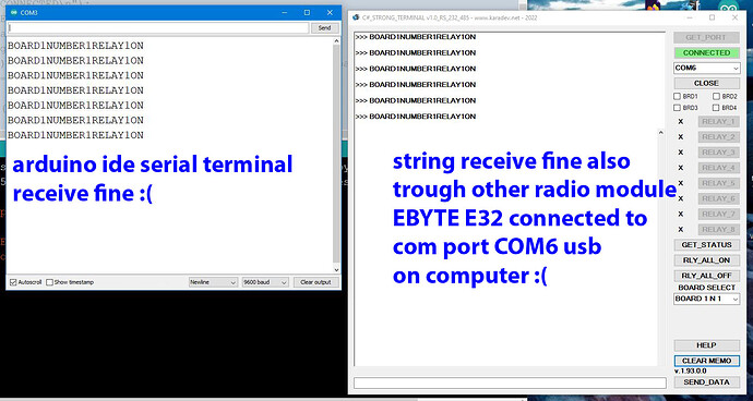

I want through the serial port of the USB board shown in the picture to be able to receive/send the same strings that I receive/send over the lan network. a kind of echo for the commands that pass through the LAN link between the client and the server.
viber_image_2023-01-22_10-33-32-041|666x500
however, there was a communication problem that I assume has happened to other users. I make my serial terminal program in visual studio C# programming language, standard windows application project with ready made serial port module/component from visual studio.

to the board, as you can see, there is a connected module of the company EBYTE E32 radio module 433MHZ, through which the string messages are received and transmitted normally, just as they were written in advance in the source code of the terminal or as you can send yourself a random string message from the command line at -down in the program.

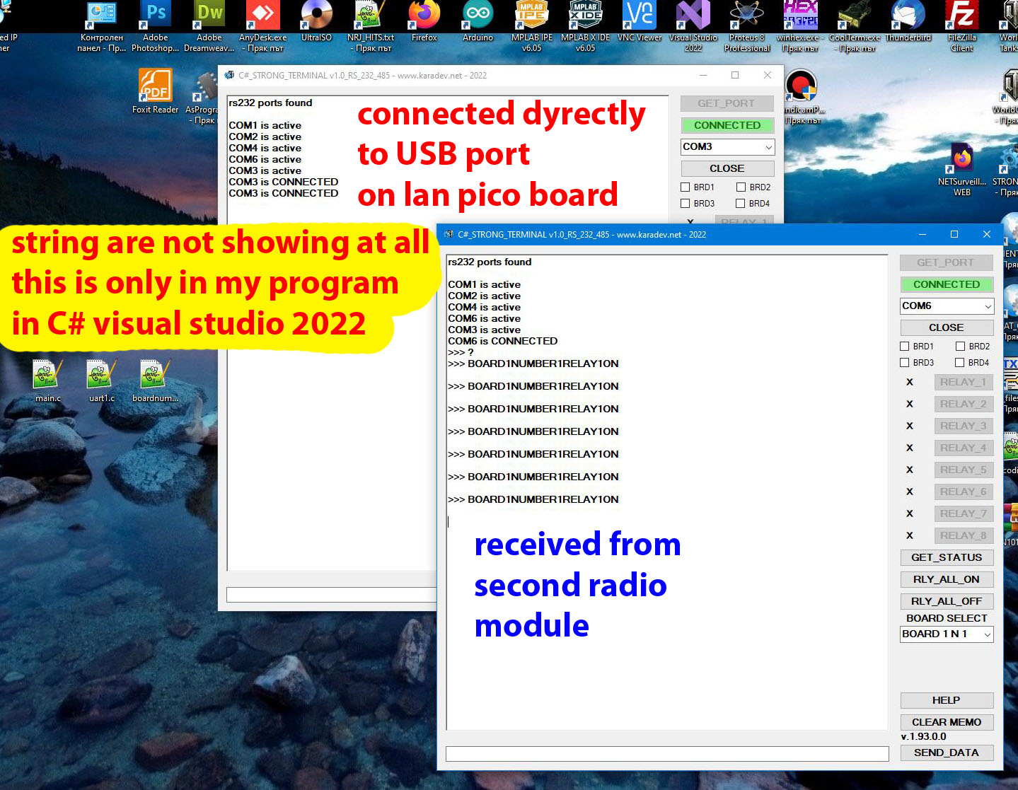

the problem is that on the USB serial port of the LAN PICO BOARD connected with a cable to the computer, the messages are sent normally and in the serial monitor of the arduino ide 1.8.19, the strings are visible normally. also in the COOL TERM program when I connect to the USB serial port Serial.xxx(); strings are also received and transmitted normally. only my program developed in C# does not want to accept and pass them from the board and to the board.
if anyone has had this happen to me using C# with visual studio for serial port please share how they solved this problem.

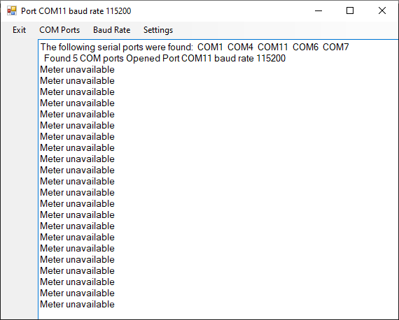

you C# serialport code looks similar to mine so no idea why it does not work
e.g. my Form1.cs may give you some ideas

the code running
I scan the COM ports , list them under Com Ports menu item and then selected COM11
you can see the output of an Arduini Mega

as I showed in the previous pictures, there was no communication on KOM3, unlike other com ports and other programs, now everything is OK !!! :slight_smile: after 3 days of struggle and sleepless nights, everything is now OK
