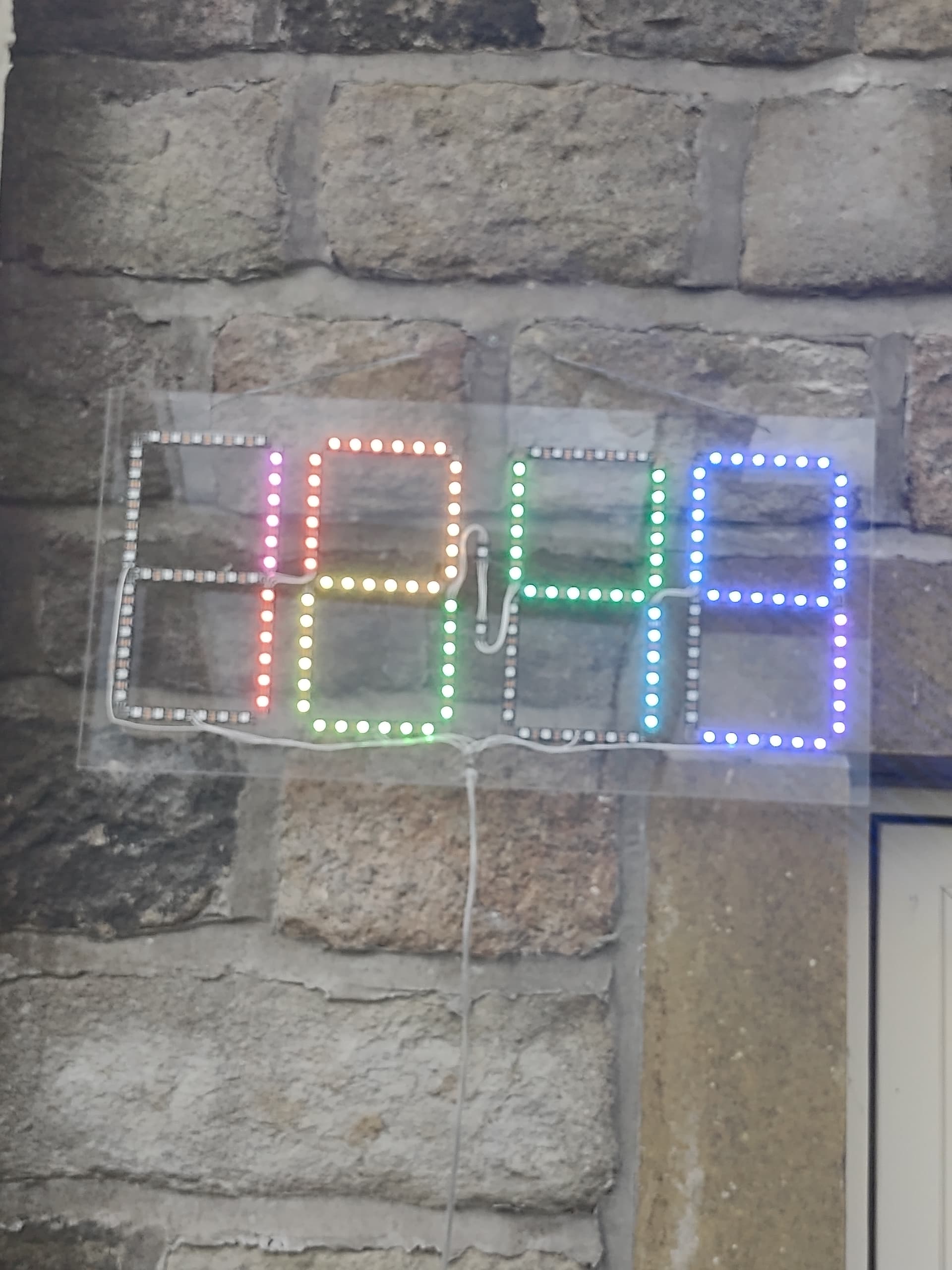

I am at the early stage of programming a neopixel to give me a choice of numbers (and colours) but I am stuck with the correct protocol.
If I make the first 'if' statement
if (choose[i] == 1)
trying to get it to choose between array two or three I get
'Compilation error: invalid types 'char[int]' for array subscript'
If I comment it out and uncomment out the line above
if (two[i] == 1)
so I just get array two
the compile works?
What do I need to use to make the sketch allow me to choose the array I want?
