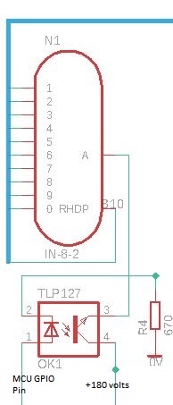

I found a Nixie clock schematic and it has an interesting way of switching the anodes. Here is an extract:
( photo darlington optocoupler )
The full schematic: https://raw.githubusercontent.com/microfarad-de/nixie-clock/master/doc/nixie-clock-schematic.png
The design uses a TLP127 photo darlington optocoupler to switch 180v in emitter follower mode. The optocoupler is specified for up to 300 volts
TLP127 data sheet: https://toshiba.semicon-storage.com/info/docget.jsp?did=16902&prodName=TLP127
Unfortunately, I can't easily get a simulation model of this device (LTspice) to see what happens when it is switching this voltage and can't see how the base of the first transistor is biased etc., but can a user generally assume that if the datasheet of a photo darlington optocoupler is specified (normal operating parameters) for a Collector Emitter Voltage of X volts, it can switch X volts and this is independent of the connection topology emitter follower or common emitter ?

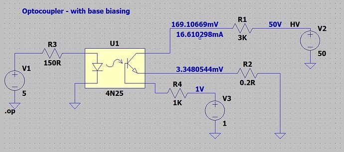

OK @Raschemel, thanks for all that and a very entertaining style too. You did understand the the construction of the that particular optocoupler was a photo Darlington pair and the conventional model in the specification has a representation of a base (even though it is not externally exposed in that case). My reference to the first transistor, in case it is not clear, was to the first transistor in the Darlington pair facing the LED.
I'll simplify it a bit with another optocoupler (this time a single transistor design) which additionally exposes the base for optional external biasing. This one I can simulate in LTspice. I have 2 diagrams, one without external biasing on the base and one with some. In both cases, I am driving the internal LED hard. Without external biasing, I am losing about 8 volts over the optocoupler although I believe I am staying in specification for the device. With external biasing, I can eliminate the voltage drop. Hence may original question relating to the voltage which could be switched with such devices.

The conclusion I make from this and the comments received (thanks also to @Paul__B) is that if an Optocoupler does not provide an external base connection, the user can assume that it is capable of switching, without significant loss, the maximumum Collector-Emitter voltage specified (as long as everything is with in the normal specified operating parameters). In other words, the internal LED is capable of fully saturating the (output) transistor and the opto coupler functions equally on the high side or the low side.
You're only driving the led with 33mA. (SEE PAGE-6 of datasheet top right plot. Look at the collector
current difference between 30mA and 50 mA forward current )
Try changing the led resistor in the first simulation to 100 ohms for 50 mA.
OK. You were right about the LED resistor being too high. Assuming a forward voltage of 1.4V, the resistor should have been 72 ohms for 50mA which appears to cause the output transistor to saturate without external bias under these test conditions. I've revised the simulation:
