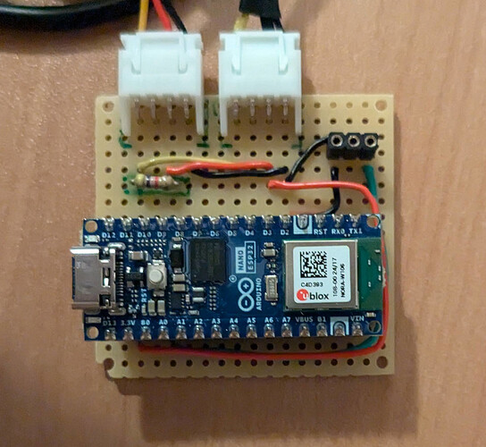

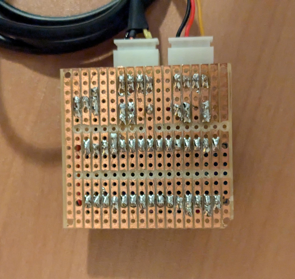

I've a strange problem with using two DS18B20 sensors on the Nano ESP32. I'm using the following circuit (the buzzer is not connected atm):
And here are some pictures of my board:

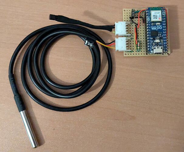

Please, show the picture that shows the connection of the sensor (s) and Nano ESP32.
Here is a picture of the sensors connected to the board:
Also have a look at my first post for more close-up pictures of the board.
I've tried different configurations, i.e., only the small sensor connected, only the sensor with the cable connected, and changing the ports.
Is that an orange band on that resistor? (47k)
Leo..
I would like to go with 3.3V bias voltage for the sensor instead of 5V (VUSB).
I just double checked it, it's a red band. I also measured the resistor and it has 4.7k as expected.
I would also like to stick to 3.3V. My plan is to try a 3.3k resistor first. I need to remove the current resistor anyway for both solutions and replacing it is quite easy. I just need to organize one, since I have no 3.3k resistor here. If this doesn't work, I'll try to go with 5V instead of 3.3V. But this requires additional changes to the board.
