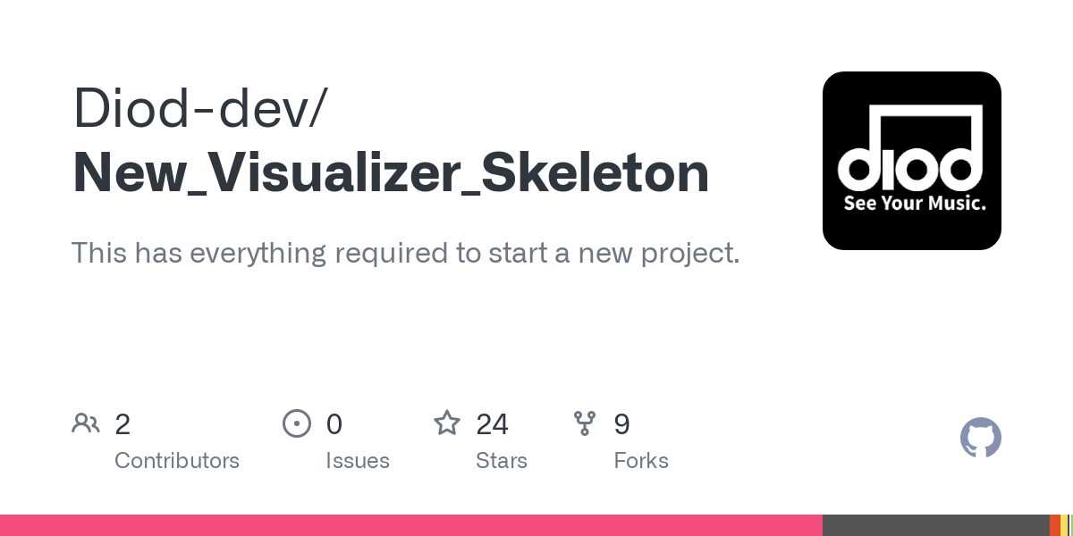

diod-dev uses a teensy in combination with an esp32 or an FFT library and do the coding by myself but I don't want to reinvent the wheel.
I hope that someone could help me with this journey and finally get to a working program that works
