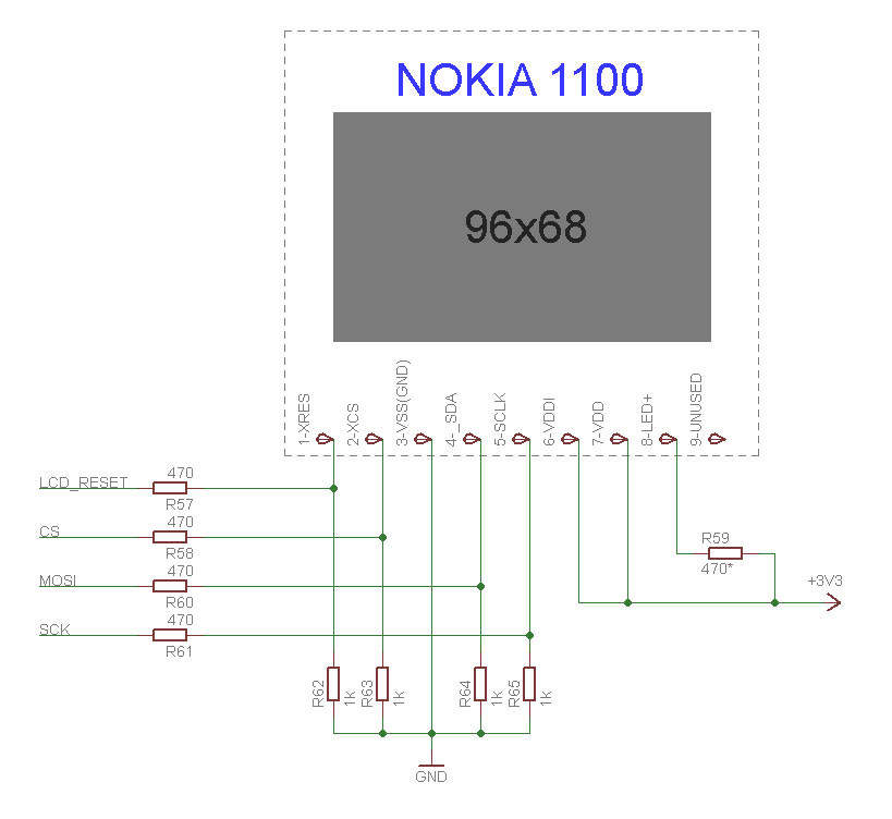

I build project that want use two nokia 1100 lcd (PCF8814) as output my info.
I try many library from github dev.
I try one by one that library on 5 types nokia 1100/1110/1116/2115 (use pcf8814 controller) that i got, and it works for displaying info.
Only need little modification on initialization sendByte lcd data if some lib wont display on some lcd
My problem is when i try to set diferent output to dual display... its not work
Only lib was made by Igorox that i see include SPI code , but i cannot use this as well.
The lib is use SoftwareSPI and HardwareSPI in the code, when i use Soft SPI setting, and assignment the display pin that i chose, it works great and no problem
But when i set to HWSPI...
using pin 13 as SCLK, pin 11 as MISO, and pin 10 as SS in default code, pin 9 as RST,
And try to add second display with use pin 8 as SS and other pins are shared to first display, i only got output in first display.
The second display is always blank
Anybody can help me to explain for use that lib to multi display please.

MY PROBLEM FINALY SOLVED :slight_smile:
The main problem when using LCD NOKIA series with PCF8814 driver for dual-display or more,
is on the initialization instruction command sequence.
After trying several times combination, I finally found the perfect combination for use in the multi display.
Especially if the screen is used, use of different manufacturers' serial number

Here the common part initialization code sequence that most compatible for many PCF8814 NOKIA DISPLAY (96X65) .
was tested in my 5 diferent nokia 1110 lcd that i got, and works perfect in single or multi display with this driver.
