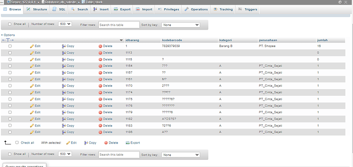

hi everyone, i got error code 400 while sending data string barcode from esp32 to mySQL database.
but when the sensor reading is not correct, the data can be sent to the database
my code

I still haven't found the solution
the barcode code has been read, but like this
</body></html>
http://192.168.0.67:80/sobsite/update_fcn.php?kodebarcode=A0716272
&kategori=A&perusahaan=PT.CintaSejati&jumlah=1
HTTP Response code: 400

I'm still facing the same error, when I enter the link from the serial monitor to the web browser, the data goes to the database
What do you see in your server logs?
How to see the logs ?
Also, check what you're actually hitting in the browser. That 302 may indicate that your site requires https and the browser is redirecting, but your ESP isn't equipped to do so.
ahh i see, but now i have a problem with bad request 400, when i fill in the data manually it can enter
Solved, I use POST methode
