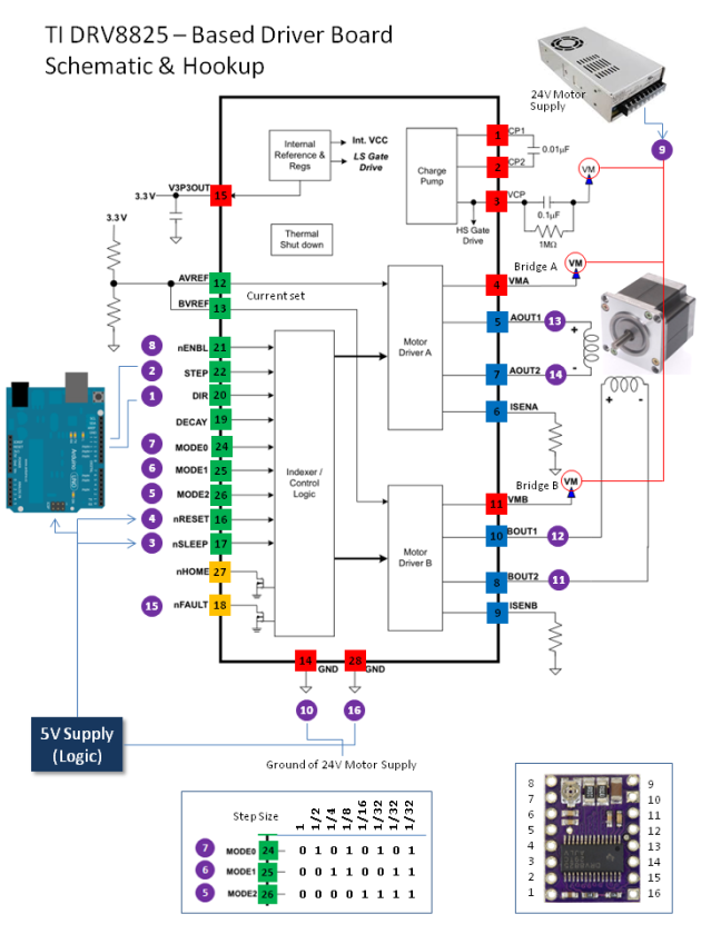

Hi i just got a DRV8825 driver and a 23km-C051-07V stepper motor wired as per pic but with an Uno and on pins 3 and4,
and have got it working on the following sketches;

If it does NOT move in both directions with that code please make a pencil drawing of how everything is connected and post a photo of the drawing. A photo of your hardware is not suitable.
