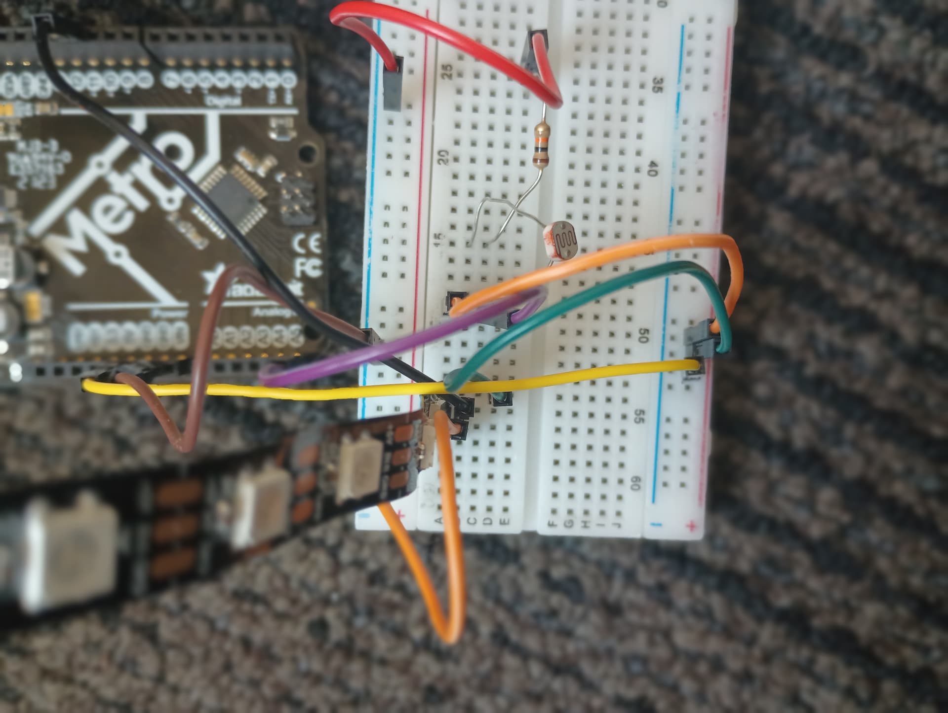

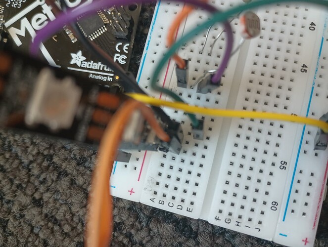

Hey yall. Trying to get a photoresistor to work and I can't seem to make any progress, it only seems to detect max voltage. Any signs of where I'm going wrong in the breadboard or in the code. The later code isn't finished yet but it shouldn't effect it as it revolves around received readings.

Your purple wire is connected to the wrong leg of the photoresistor.
It wants to connect to the junction of the photoresistor and the resistor.

Thank you, It's working properly now!
