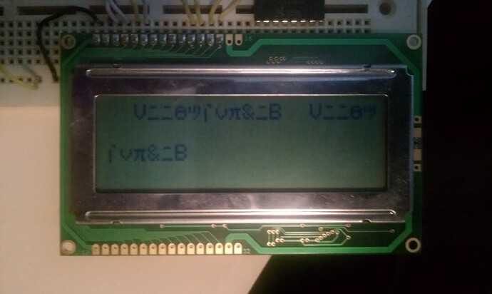

Solved!! LCD question... hello world example doesnt work but other code does
Hello I have been draw to the arudino world its been fun so far!
just got my board a couple days ago, I been doing all the examples.
Now I am trying to do the LCD Hello World example.
It prints wierd stuff to the screen
The screen I have is a Seiko Instruments 20x4 5x7 char model #L2034-00J I got it free so why not use it :slight_smile: I do have the data sheet for it.
The only time I can see Hello world is when I use this code below... but modified one of his lines of code to say lcd.print("Hello World"); instead of lcd.print(thisLetter, BYTE); because when I compiled (using Visual Studio 2010) it reported BYTE is not used no more use Serial.write this confused me so I just threw "hello world" in and it does print hello world and scrolls it thru the screen witha bunch of H's)

LCD screen fills the first line, then third, then 2nd, and last forth (this is normal I think). Same char displayed every time I load the sketch.
Here is some pictures of what shows up on my screen.
The first pic is with the code in this attachment.
The second Picture is with the the code I posted with all the loops. What you see on the screen is a bunch of weird text scrolling at first load, then couple seconds later the "Hello world" starts scrolling throw first line, then 3rd, then 2nd, then 4th, appears to be char overrun. but while its doing this the H stays behind and covers the weird unknown text. I can get it to display hello world standing still by using the loop code and inserting lcd.setCursor(0,0); after the loops. But Never with complete removal of the loops. Screen is either blank or weird depending code.

I think you mean the same sequence of characters .... This would indicate that you are not getting random errors.
Now you have to compare the binary values for the characters that you are sending to the display to the binary values for the characters that you are seeing on the display. You will probably find that you have a bit stuck high or low or two adjacent bits tied together.
Without doing this analysis I would suggest starting out by looking at D4 since this will have the least effect on the initialization (which obviously worked).

I just removed all but first three wires on the LCD, my first and 3rd line light up and yes the contrast works. 2 controllers maybe?
ok just rehooked wires up, I will attach a picture, I never soldered anything, my lcd came with male headers. Nothing flaky about it, it prints to the screen just fine when using this code

Here is pictures. I took 2 pictures from different angles and I am using LiquidCrystal lcd(7, 8, 9, 10, 11, 12);
If anyone finds I wired something wrong I will be LMAO! cause I checked and rewired 3times now several different ways and all my other projects work great! even the servo motor control. Btw that chip is not being used it just sitting there from my motor control i did.
Its not pretty wiring but you can see it, and this is the second breadboard too. every time variable same result.

I forgot to add the pictures, Here is a picture using the simple setup code, and lcd.print("helloworld!"; 2 times. see picture. It seems my LCd screen is stuck in some special character mode. Would timing produce the same screen prints, seems link timing would be more random, but I don't know. Also I have no clue what the ascII of this print screen is.. LOL
There should be 13 char on the screen, but only 11 show, and if you look close the kinda (Z) thing should be the (L's of "hello" and "world"), so it appears the (H) does not ever get printed, maybe it is timing. And the timing is what causes the special char as well. Dam I got move the lib and try liquidcrystal1.0
Take care thanks
