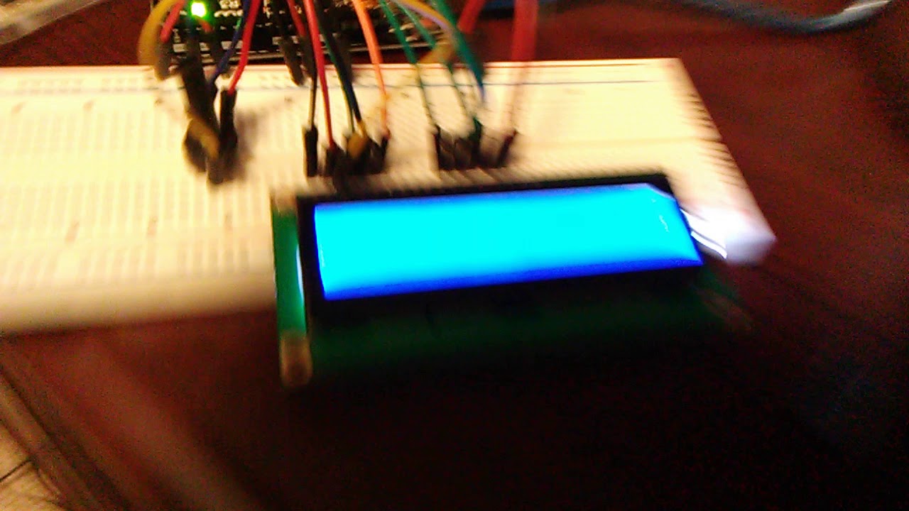

hey all i am new to arduino.. to make a loooong story short, i need help with my very first code!! it is the lcd arduino, i compiled a sketch and uploaded to my board, and it is very strange.. i can print numbers but not any kind of text or letters.. so hello world just wont print to the lcd.. if i try to use ANY kind of letters, it wont work.. only dislays weird lines and question marks.. but if i enter and numbers in the lcd.print it WORKS FINE!! hmmm anyway, here is my code (sketch) any help would be great !! thanks::

what is controller you are using. what screen is displaying
This might be vary big text. first try with simple hello world

Now, check your wiring to pin 11 of the LCD. When having problems with Chinese "Dupont" wires, test them all.
Oh yes, we assume you have actually connected the Arduino to the display. We have had people ask questions and it turns out they have not connected the two but have some pins leaning against the terminals instead of being soldered. :astonished: That sounds unutterably foolish, but it has happened!
hey thanks for the replies.. i am not home at laptop at moment but i will do all the code post instructions as soon as i get home.. but yes.. i AM connected to the board and there are NO errors when compiling or uploading.. ALL IS GOOD EXCEPT.. for when i type NUMBERS in the lcd.print () it will output fine on the 16,2 size lcd screen.. BUT if i try to type normal LETTERS (text) it just displays blinking little lines and an upside down question mark.. hmmm and the "counter" wont work either.. BUT if i type ANY OTHER character in the lcd.print function that is NOT a letter, it works just fine

Check your wiring between pin 11 of the Arduino and pin 13 (D6) on the LCD. Check your soldering to that pin on the LCD. Try another jumper wire (OK, they are not "Dupont" jumpers).
To test the jumpers, wire a LED and series resistor on the breadboard to the 5 V and ground lines, using the jumper wires. If you have an empty breadboard, you can test all your jumpers at once by making a "chain" of them back and forth from one column to another and putting that in series with the LED and resistor.

okie.. i took out the 11 pin jumper wire and tested it and made sure all was good.. curiously when i pulled it out, LETTERS appeared chaotically on the second line..hmm but when i inserted the jumper wire back into the pin on the board and the breadboard.. im still getting the same weird characters and only numbers will display.. i mean if intergers will display on the lcd would not "hello world"????? as far as physical connections all seems good and secure .. i am just so confused over this.. im not even getting any errors messages.. i just dont know what to do..
OK, now connect that jumper between pin 13 (D6) on the LCD and pin 6 of the Arduino instead of 11, and change

What you saw clearly is where the problem is; there is a bad connection somewhere, just a matter of tracking it down. Those jumpers use some sort of glue or varnish and sometimes some of it runs down over the pin at the end and coats it as insulation. This may not even be noticed during testing.
