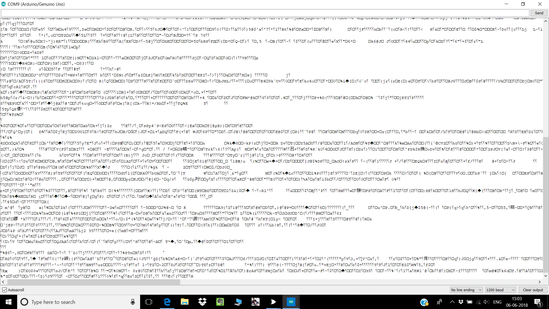

Hi my MPU-6050 is giving me unknown outputs that is not readable. Is there any solution?
deveshsnair:
Change the baud to 38400
