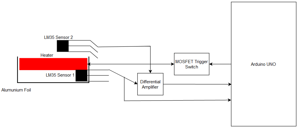

I don't have the schematics for all of the components but here are the components I've used so far.
I used 2 LM35 sensors for 2 purposes first sensor is to measure the constant temperature, the second sensor is to measure fluctuating temperature (using arduino serial monitor and multimeter showed the same result in windless environment). 10mV = 1 degree Celcius. For the heater, I used 3d printer ceramic cartridge heater (I don't have the datasheet because I couldn't find any). This heater is controlled using pid controller to maintain constant temperature. The differential amplifier is used to calculate the heat loss based on voltage difference (then the value is amplified 100 times to make sure arduino could read the low voltage from measurement)
Thanks for the process explanation, you could have done the differential amplifier in software and two analog inputs.
That way you could monitor the performance of your project.
Is it possible to use algorithm (or mathematical equation) to determine the wind speed from either heat loss or voltage loss?
No. There is no explicit algorithm or mathematical expression relating those quantities for your device.
The basic thermodynamic and fluid dynamics laws (differential equations) can be used to model the behavior, but that step depends very strongly on the details of the physical construction and the properties of all the materials involved in the device. In any case the results would have to be verified by experiment.
To calibrate your device you will need a third sensor to measure the ambient air temperature.
You have come far enough along with the construction phase of this project. Don't you think it is time to start doing some research of your own to learn how they actually work?
