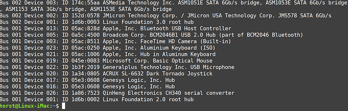

I have an issue on my iMac with Linux mint 21.3 on iMac. There is no ttyUSB port available. I have used "sudo removed tty blk". This helps on other pc perfect but not on iMac.
ls /dev/tty*

horst@Linux-iMac:/home$
Isn’t that port made available when the OS recognizes a USB device?
You might be missing the proper driver.
Did you get that list with your Arduino already connected? What Arduino are you using?

I see "Bus 001 Device 026: ID 1a86:7523 QinHeng Electronics CH340 serial converter" This is my board. But i can't see this port.
On other usb drive.

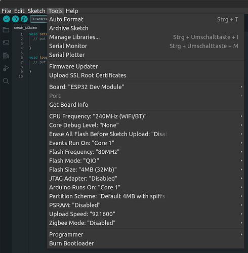

./arduino-ide_2.3.2_Linux_64bit.AppImage. Does not work.
Wait, it's flatpack. I install version 1.8.19.
I recommend using the official build of Arduino IDE downloaded from the "Software" page of the arduino.cc website:
The 3rd party maintainers of the Arduino IDE packages that are distributed via the various package repositories sometimes make unspecified modifications (as may be required for acceptance to the repository) and those modifications sometimes result in the version of the IDE from the package repository having different behavior than the official distribution. In addition, the package manager framework itself may cause differences in behavior (e.g., due to sandboxing). The helpers here on the forum generally use the official Arduino IDE distributions so might not be as familiar with the quirks of a 3rd party package.
I will say that the maintainer of the Arduino IDE 2.x Flatpak package does an amazing job of maintaining and supporting that package, but I don't know anything about the state of the Arduino IDE 1.x Flatpak, which has a different primary maintainer.
Your screenshot is definitely of Arduino IDE 2.x.

Could be that...
Thanks for your tip, but I have a lot of PCs with Linux Mint 21.x. But I always solved the problem with the lack of USB access with this command: “sudo apt remove brltty”. This works on all PCs, but not on my iMac Linux installation. I have never installed CH340 on any Linux. It's not just about this one board either. There is no USB port in the Arduino IDE on any board, except my network ports to OTA boards. But this is about the visibility of the USB port itself. So ttyUSB0 or ​​similar. But it won't be visible.
I found the solution. It’s often not enough to simply execute "sudo apt remove brltty." In Synaptic, I removed brltty there. There were some dependencies that were also removed. After a restart, voila, the Arduino IDE shows the ttyUSB0 port. I hope someone will look into this issue on Linux Mint. Thanks to everyone who helped me out.
Unfortunately, I was happy too soon. I now see ttyUSB0 in the Arduino ide port selection, but there is the error message:
Der Sketch verwendet 266073 Bytes (20%) des Programmspeicherplatzes. Das Maximum sind 1310720 Bytes.
Globale Variablen verwenden 20184 Bytes (6%) des dynamischen Speichers, 307496 Bytes für lokale Variablen verbleiben. Das Maximum sind 327680 Bytes.
esptool.py v4.6
Serial port /dev/ttyUSB0
A fatal error occurred: Could not open /dev/ttyUSB0, the port doesn't exist
Fehlgeschlagenes Hochladen: Hochladefehler: exit status 2
Which is actually a joke. As soon as I remove the board, ttyUSB0 is gone too. When I reconnect it, the ttyUSB0 is back. Yes, and the board is ok and the cable too. I have another computer next to me with the same operating environment but no iMAC. I can burn the board again and again on this computer. Anyone else have an idea?
