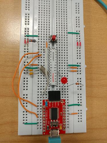

Hi guys, I'm trying to set up an atmega328p-pu on a breadboard and trying to program it using a FT232R breakout board.
I feel it should be an easy task, but I just cannot figure out a solution.
I bought the MCU which has an UNO bootloader and 16 Mhz crystal.
I have set it up as you can see below:
(Some decoupling caps are missing - would that make a difference?)
When I upload the blink example I can see the heartbeat on the LED and both the TX and RX flashing.
The code "seems" to upload successfully as I get the following output:

Make a pencil drawing showing your connections with everything labeled so we can read it and post a photo of the drawing.
Do you have a connection from DTR to the reset pin on the 328?
I run all my breadboard 328s using the internal 8MHz oscillator.
Nick Gammon's diagnostic programs may help, And also see his bootloading tutorial
...R
Yes, it does.
I see you are using "Pin 19" for your LED pin but you have the LED connected to Pin 13 like a normal Arduino. Just because your Arduino is on a breadboard doesn't mean you should start using the ATmega328P-PU pin numbers instead of the Arduino pin numbers. That's why you have the pin number label on your chip!

Yes, it was embarrassingly simple! I just had initialised the wrong pin number in my code. Should have been 13 as you said and I can see the LED blinking now. However, the delay function doesn't seem to work properly when I pass in different values now. I will have to look into this but at least the code uploaded.

I know that the program uploads because I could change the pin numbers and they flashed accordingly.
Also added some decoupling capacitors and changed the power source from usb to power supply but not lucky yet.
I'll come back after I've made some progress..
Thanks.
Have you fitted bypass capacitors yet?
You are changing both delay functions?
Tom.... :slight_smile:
Hi there,
So I disconnected everything and started on the breadboard again. Checked all connections, re-installed Arduino IDE, and got a different USB cable.
I have placed capacitors across Vcc-Gnd rails.
Then tried passing in some ridiculously long numbers in both delay() functions but still flickering at a high rate...
I feel the oscillator is a problem here but can't quite figure out what could have gone wrong.
The settings in boards.txt seems fine to me but it appears somehow the oscillator at 16 Mhz is not syncing correctly with PC commands..

Any of your expert opinions on clock settings & timing with mcus would be much appreciated..! Thanks.
Just running this piece of code for testing purposes:
#include <avr/boot.h>
  int lf = boot_lock_fuse_bits_get(GET_LOW_FUSE_BITS);
  int hf = boot_lock_fuse_bits_get(GET_HIGH_FUSE_BITS);
  int ef = boot_lock_fuse_bits_get(GET_EXTENDED_FUSE_BITS);
  //Serial.println("\nLow Fuse Bits: ");
  //Serial.println(lf, HEX);
  //Serial.println("\nHigh Fuse Bits: ");
  //Serial.println(hf, HEX);
  //Serial.println("\nExtended Fuse Bits: ");
  Serial.println(ef, HEX);
When I run it, it only outputs "\nLow Fuse Bits: " continuously. I then commented out the rest of sections to retrieve each fuse values. The returned values didn't match up to my settings in boards.txt. It must be a communication interference producing garbage right?
Have you tried Nick Gammon's programs that I gave you a link to?
...R
tldbs0204:
The fuses only get set when you Burn Bootloader. Did you do that successfully?
Robin2:
...R
Hey, I ditched the AVR Pocket Programmer and got a Mega2560 to re-burn the bootloader and finally everything works now! I also checked and confirmed the functionality on my other spare mcu successfully.
I was going through so much trouble with the AVR programmer but using another Arduino was so much simpler and easier - lesson learnt: own a good working Arduino for troubleshooting & peace of mind.
Thank you all so much for your help!! I really appreciate it!
Hope you have a nice day. :slight_smile:
tldbs0204:
+1
...R
