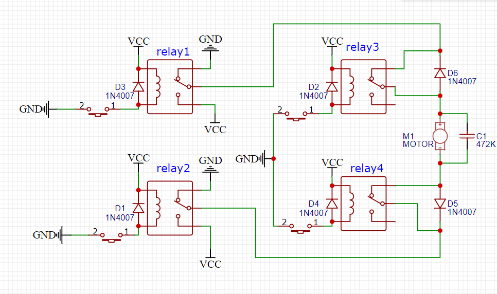

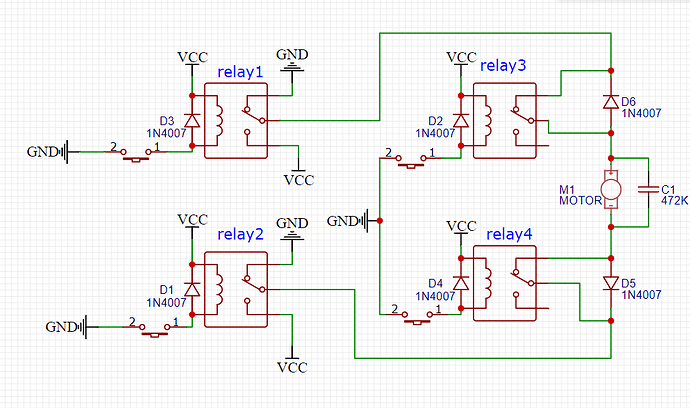

based on your and @build_1971 comment this is the updated drawing
Im using a 472K ceramic capacitor with diode and Im using to drive my car power window. imma try it right now. please let me know if there are anything I missed
thank you

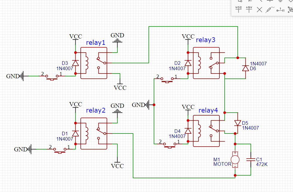

edit: I tried this diagram, with the diode but when relay 3 trigger, the motor do not stop. what I`m trying to do is either one of the relay 3 or 4 trigger, the motor stop. but so far if I disconnect the diode, the motor behave exactly as expected. how do I make the motor stop?
You cannot have the diodes where they are now. They should go to plus and ground.
That is a good trick a capacitor normally has its value in micro or nano farads. Resistors are measured in K.
Diodes D6 and D5 are wrong. To correctly apply flyback diodes to bidirection motors you need:-
can I know what would happened if I did not use D5 and D6, instead I just directly connect it to my motor?
I tried it and the motor still runs, does it have an effect on the long run?

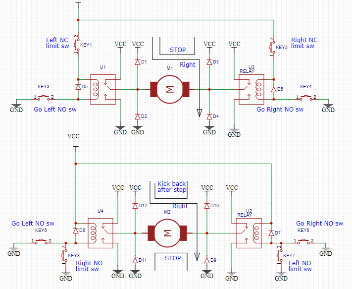

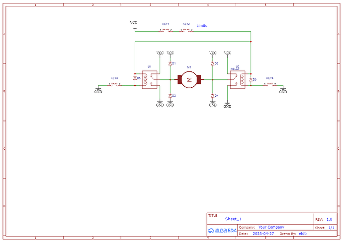

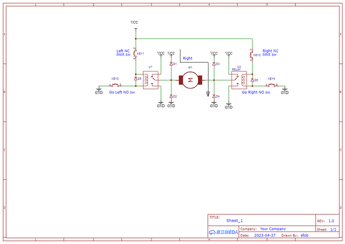

good day, i just update my drawing and here is what i come up with
imma try it in a bit and let this thread know. thank you kind sir
One more:
How do you get the motor OFF the limit switch with your circuit?
When the limit is hit, there is no power to operate motor relays fwd or rev.
By the way your limits should be normally closed, not normally open.
Yes, I can't find the symbol for NC switch.
This should work
