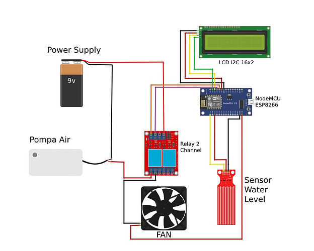

I'm currently working on a project that uses relay and water level sensor. The problem is, the relay won't switch and I was wondering whether its the program issue or hardware issue.
I'm unable to give you guys the picture, but the wiring is like this:
Relay 2 channel
DC + -> VCC of 5V Power Supply
DC - -> GND of 5V Power Supply
IN1 -> D3 NodeMCU
IN2 -> D4 NodeMCU
When I first power it up, the relay definitely switch, but when reaching the logic of the program, the relay stay silent.
What I want to achive is, when the program starts working R1 is on, but when the wLevel reach 2cm, R1 OFF and R2 On activating the water pump till the water is empty, then R1 is on again.

your delays() prevent the run() functions of the loop to run... blocking code for 7 seconds is a loooooong time
try rewriting this without blocking

Hi, @jeonsann
Have you written some code to JUST test your relay?
If not then it might be a good idea to make sure it is not a hardware problem.
Thanks... Tom... :grinning: :+1: :coffee: :australia:

This is the wiring diagram:
So, using delay is not going to make it happen?
Yes, delay() is very often hindering as it does not allow the controller to read sensors as quickly as required.
In your case you have defined a function wLevel that should be called every 100 msec while inside the function you use delays of 2000 and 7000 msec.

Hi there and welcome back!
Good diagram you produced, and being cooperative show us that you're serious about the matter. By the way, what software / website did you use to make the diagram?

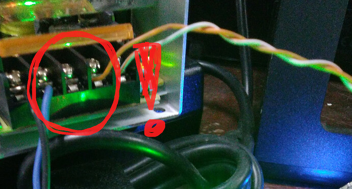

Hi, @jeonsann
Please show what your real power supply is.
Can you please post some pictures of your project.
So we can see your component layout.
The wiring of the relay does not look as thought it would do what you need.
Hi, Tom. This is the picture of my components.
Thanks.. Now reverse engineer it.
And please post a copy of your circuit, a picture of a hand drawn circuit in jpg, png?
Can you please post a link to data/specs of the relay module?
It has some jumpers.
Thanks... Tom.. :grinning: :+1: :coffee: :australia:
Have you got a gnd connection between the MCU and the relay module?
Please include ALL connections/wires and pin names.

Hi Tom. I changed the relay with the black one, and the switching problem is solved. But there's another problem, the relay will only active when i connected VCC and GND of relay to VCC and GND of NodeMCU. I tried to use the vcc and gnd of power supply to power my LCD but, it just showing blank black bar.
