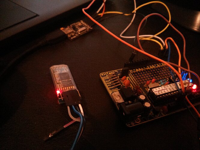

The Android app sends multiple text fields that have a ~ to delimit them. Via software serial these arrive as expected, but my code never sees a delimiter when the bluetooth module is on the serial UART. Initially I echoed this to the character LCD but made up this test rig to prove there was something wrong with my project hardware, but am actually seeing the same behavior, so something is wrong with just the code I've isolated here somehow.
Attached is a camera phone image of the hardware of the test setup. In the rear is the FTDI adapter hooked up to the software serial pins 2 & 3 and also powering the rig. In the foreground is the HC05 module.
Thanks for sharing some brain cycles on this,
Geoff
