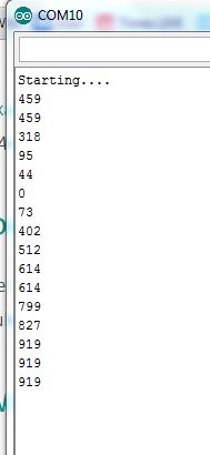

Are you using digital pin 0 to read a analog value from a pot. :o
You should also use pinMode to declare the pin an input.

BZZZZT.... wrong on both counts hd123.
The code below produced the attached output.
// test pot on analog 1
  Serial.println("Starting....");
  Serial.println(analogRead(0));

Clearly pin 0 is an analog if it works. Usually A0 is used for analog pin 0.
You don't need to use pinMode when using it as a input, but you should.
