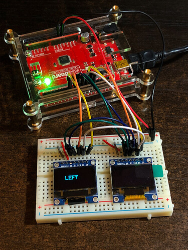

I'm having my first try at multiple displays, and it isn't going great. I'm sure this is something I'm doing wrong, obviously, but I can't figure it out.
I have a mix of little .96 128x64 OLEDs, with a mix of interfaces:
  • 2x I2C
  • 2x SPI with 7 pins (one white display, one yellow/blue, if that matters)
  • 1x SPI with 6 pins (no reset)
I'd like to use (any) two for this project.
Unfortunately as far as I understand I can't use both I2C displays without re-soldering a tiny SMD on the back. Correct me if that's wrong.
Before I risk that I figure I could try the SPI. To at least get things to work I am sticking with only the two SPI with 7 pins. Even though the colors in the display are different, I assume they both function the same connection-wise and code-wise?
Regarding multiple SPI devices, I have read two slightly contradictory things:
  1. SPI devices can share all of the pins except each device must have its own CS pin.
...or...
  1. Each device must have its own CS AND Reset pin.
I've tried both of those options.
As you can see in the photo, the CLK (D0), MOSI (D1), and DC pins from the left go to the corresponding pins on the right, then over to the Redboard.
The CS always go to separate pins on the Redboard. In this photo the RST pins also go straight from each display to the Redboard. (But, again, I also tried with both Reset pins going to the same pin on the Redboard.)
Here is my code:

No matter what I try, I can only get the left display to work. The Serial monitor just says "SSD1306 allocation failed: right".
I can switch the actual displays, and still only the left one works, so it's not a faulty display.
I assume I'm missing something obvious, and I apologize about my lack of knowledge regarding this.
Also, I assume I could mix one SPI and one I2C, but I feel like I should learn how this works anyhow, before going with a workaround like that.
Thanks for your help.

Tip #1. Post links to your custom boards e.g. Particle Photon and Redboard. Also your screens.
It appears that Particle Photon has an M3 chip with plenty of SRAM
And the Redboard has a humble ATmega328P with a meagre 2048 bytes.
Adafruit_SSD1306 library allocates 1024 bytes for each screen buffer at run time. The Reboard will never be able to handle two screens.
It should be possible to use 2 screens with Adafruit_SSD1306 on the M3.
It should be possible to use 2 screens with U8g2 on the M3 and on the 328P. (but software is different)
David.

Multiple SPI displays should work. Separate CS pins. Separate RST pins (or RST= -1 in constructor)
Multiple I2C displays should work. Separate Slave address 0x3C, 0x3D.
Multiple SPI and I2C.
Adafruit libraries allocate 1024 bytes SRAM for each 128x64 display. So you need a BIG Arduino.
U8g2 library can use a small "paged" buffer. The coding is different. But you can fit multiple 128x64 on a Uno.
David.
