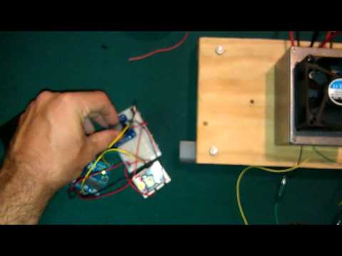

Good day,
Finally after many obstacles, faulty wires, wrong code etc... success :grin:.
I present to you communication between 2 arduinos with xbees series 1 with1 joystick passing analog X&Y to other arduino via xbees wireless!!!! All using the EasyTransfer library from Bill Porter EasyTransfer Arduino Library « The Mind of Bill Porter
This sketch or method can be applied to many different project or other similar controlled bots with minimal coding expertise. I have search and red many books and none come even close to what you are about to see.
I hope you enjoy building your robots and making them controlled wireless.
Pre requisite:
2 xbees series 1 default settings(Out of the box!!) are ok but if you wish you can change the pan id but that is it!!!
1 joystick thumb joystick from ladyaya or equivalent 2 seperate joystick would work.
the way the sketch work you could have a mega arduino and include as much motors/servos/joystick/ button that you wish!!! have fun!!
2 arduino uno board
2 dc motors or servos
9 volts batterie
12/24 volts batterie
Please refer to schematic for wiring
Remote control Arduino sketch
