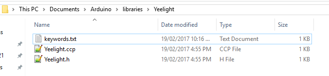

where are the library files?
Thanks for pitching in! Unfortunately changing it to #include "Yeelight.h" didn't fix it.
The files are in the library folder in documents (see attachment).
If I go Sketck->Inlcude library it is there so I think the IDE can see it.
I wonder if having the ESP code inside the library is messing it up. I'm working on a version without it and will post when I get any results.
its .cpp not .ccp
-jim lee
That did it! Great spot! Thank you!
