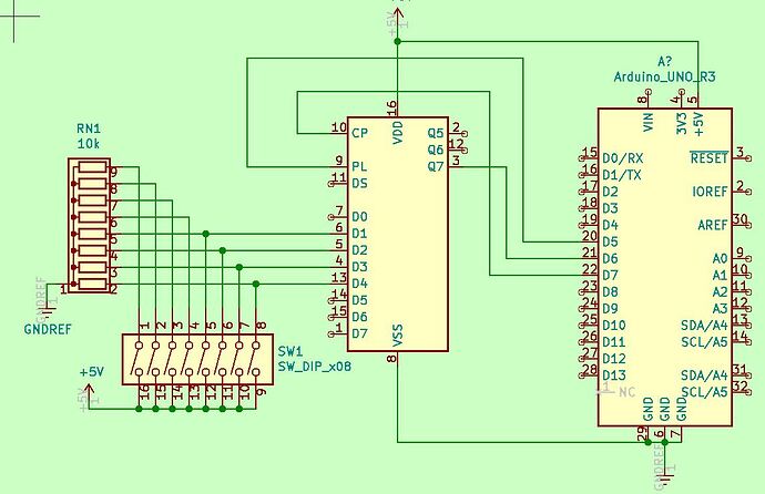

Please try the two sketches below.
Instructions are at the top of the sketches.
The first sketch uses a ShiftIn function to read the shift register data.
The second uses SPI to read the shift register data.
Both sketches work here on a 74HC165 but I do not have a CD4021B.
Please try your CD4021B on both sketches and let me know what your results are.
You will have to comment the #define HC165 line (near the top of the sketch) to get your CD4021B to work with the sketches.
Uses Arduino pins 9, 12 and 13

Attached are the two sketches.
_74HC165_and_CD4021B_using_SPI.ino (2 KB)
_74HC165_and_CD4021B.ino (2.72 KB)
