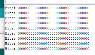

I implemented the code you provided. I understand it somewhat. I get the logic, just not always the high and low. I understand the concept, just not the practice.
When I run the code, after I changed the pins to match what I have, I get all 0's, no matter which input might be triggered.
I have two inputs shorted or closed and this is what I see in the Serial Monitor.
Ideas of what I've done wrong still?

Here is the code I'm running currently that doesn't show me when an input is "pressed".
The new version of the circuit board I have has a power input point that is tied to the ground.

This is an EasyEDA file.
PCB_Leonardo-v.4_2024-09-22.json (238.4 KB)
The code is fine. It works here, but I did have to use the only shift register IC available to me, the 74hc165.

I designed it first and am now testing it. With the code I originally supplied, the first three shift registers worked. I agree, this is like cutting then measuring, but it was the option I had.
I appreciate your help so far.
Are you testing it with actual hardware now or simulator? If you are testing with hardware, try removing the last IC and see if anything comes in. My guess is the last one may be the issue as it could be wired wrong or just shorted. Also check your orientations. The chips seem to be going in two different orientations.
If you are testing on the simulator, again start removing traces from the last IC and see if any of them were wired incorrectly.
