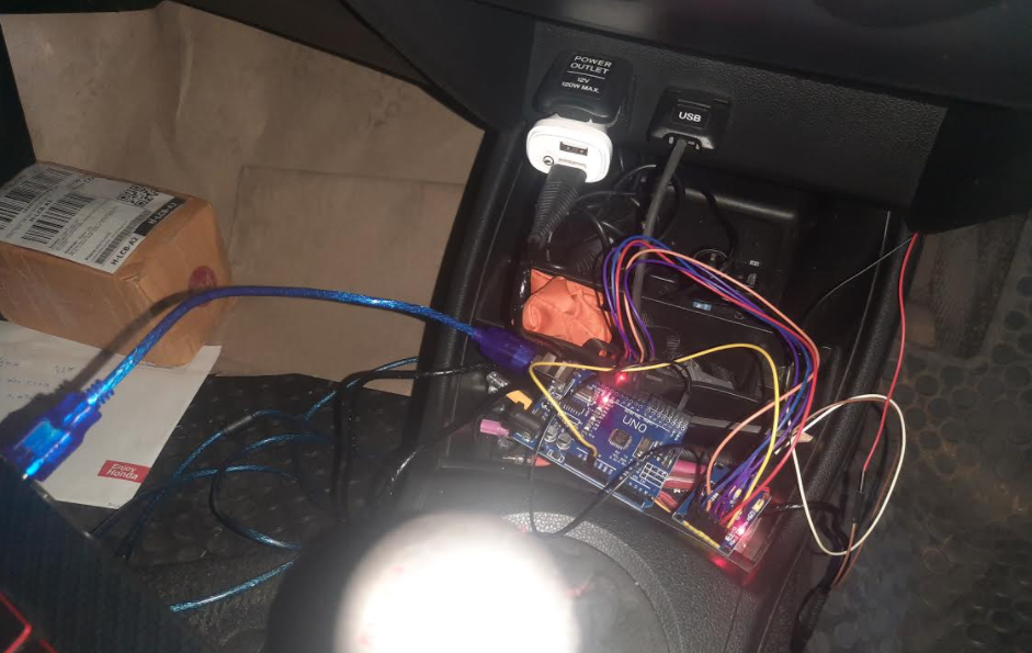

Hi guys,
I am very new to Arduino and this is my very first topic here. I am currently working on car's CAN BUS (500,000bps) communication in order to read and translate the CAN message real time. The UNO together with MCP2515 are connected to the car OBD2 port in order to sniff all supported PID data and the available output are now printed out and it looks promising enough (attached picture). However, I experienced frequent data loss, even though there is the delay of 5 seconds to read the next loop of data. I did try searching but never get any closer to the proper solution. Is this situation is called either Race Condition or data overflow? or I have to take a look at buffer size of transmitted data?

what do you see if you run the SupportedPIDs sketch?
is OBD2_02_KeyStats.ino running without reporting any error?
Hi J-M-L,
I attached the printout of sketch SupportPIDs. This sketch show only the name of supported PID on my car which seem to be correct.

And another attachment is the printout of sketch KeyStats . This sketch printout both names and values and there is still present of frequent error message and occur randomly among the shown PIDs.
