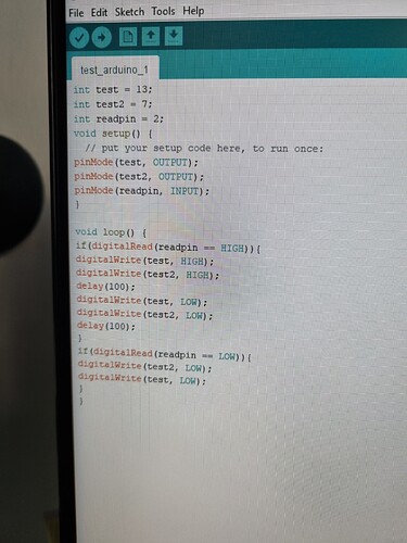

So as seen in the picture, i just want the led to be off when the switch is of. And blink when it is on. I feel like I have tried everything. Pin 2 is working as an output, but I cannot seem to understand the input function.

int test  = 13;
int test2 = 7;
int readpin = 2;
  pinMode (test, OUTPUT) ;
  pinMode (test2, OUTPUT) ;
  pinMode (readpin, INPUT) ;
  if (digitalRead(readpin == HIGH)) {
    digitalWrite(test, HIGH);
    digitalWrite (test2, HIGH);
    delay(100);
    digitalWrite(test, LOW);
    digitalWrite(test2, LOW);
    delay(100);
  if (digitalRead (readpin == LOW)) {
    digitalWrite(test, LOW) ;

Try to connect the switch to ground and use the internal pull up resistor.
pinMode(readpin, INPUT_PULLUP);
Then the input goes low whenever the switch is closed.
if (not digitalRead(readpin)) {
  // Do something.
If you use an external pull down resistor, you can leave out the not in the previous snippet.
is WRONG.
if(digitalRead(readpin) == HIGH)
is how it should be.
and use an else instead of checking the pin again
if(digitalRead(readpin) == HIGH) {
} else { // if it's not HIGH then it's LOW
you might have to deal with bouncing and hopefully you have an external pull down resistor for your switch? (you could use the builtin pull-up otherwise)
