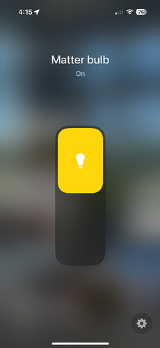

If by notify on your phone you mean will it interact with one of the smart home platforms like Apple or Google Home with their associated phone apps the answer is yes.
For example one of the example Matter sketches produces this output with Apple Home:
and the Matter bulb (in this case the LED on the Nano) can also be controlled with voice commands through Siri.
