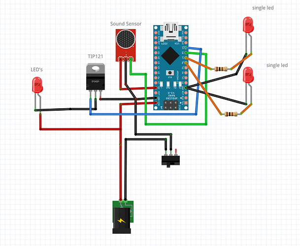

I am doing a project where I am controlling 160 parralel wired LED's with the use of Arduino Nano, a TIP121 transistor, and a FC-04 Sound sensor module. The LEDs should turn off when the threshold of the sensor is met, and then turn on again. So they react to the sound.
the problem I have is that it all works fine, until a random reset of the arduino, then it works again, and then it resets again, with decreasing time in between resets until it just keeps on resetting.
the project is powered by a 5V usb adapter which can supply 2.1 Ampere.
in the attachments there is a picture of the circuit, there is also a 330 ohm resistor between arduino pin and base of transistor.. Here is the code:

You need a current limiting resistor for each of the 160 LEDs and make sure the total doesn't exceed about 2 Amps.
Without current limiting resistors the LEDs will pull excess current from the power supply and "suck down" the voltage to the LED's breakdown voltage (about 2V).
The resistor to the base of the transistor limits the current out of the Arduino, but it doesn't limit the current from the power supply through the LEDs & transistor.
Can you please post a copy of your circuit, in CAD or a picture of a hand drawn circuit in jpg, png
A fritzy is not a schematic.
When you draw your complete circuit, show us how you have connected 6 of the LEDs, we can assume the other 154 are connected the same.
