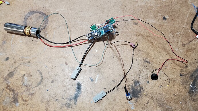

Can you post a picture so we can see the general way things are actually connected.
Basically you have pickup and this can be improved with a tidy layout.
The wiring is a bit messy so perhaps I should rewire a few of the boards. Is this caused just by how close the amp is to other voltage sources?
Here's a better view of the connections
Yes it might help tiding things up. Try and have the ground all connected to one point and radiating out to all the other things you need it connected to. This is known as star wiring.
