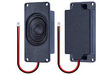

I have been looking into playing sound on a speaker (big or small doesn't matter) from an arduino (Arduino Zero due to DAC for example).
I have already researched the matter and found out that there are 2 types of speakers. Passive and Active/Powered speakers? now it seems that it is much easier for a newbie to use an active one so not to have to implement your own amplifier?
But what I can't find online is whether such speakers draw power from a power socket off the wall or the arduino? does the Arduino supply enough power to generate the sound?
example speakers:
or
and any important info I should keep in mind is appreciated

Take a look at speakers for your PC, some are battery powered, some use a wall wart which plugs into the mains. These are active as they have amplification. The ones in your picture appear to be passive.

You can not power the amplifier from the the Zero, hence two power supplies in below.
|Arduino  |       |Amp      |       |Speaker|
|     DAC o-------o       + o-------o       |
|     GND o-------o       - o-------o       |
| P1 GND  |       | P2 GND  |
+--o-o----+       +--o-o----+
+--o-o--+         +--o-o--+
|Power 1|         |Power 2|
Power 1 is e.g. your USB cable or an external power supply (e.g. wall wart)
Power 2 is e.g. a wall wart.
P1 and P2 are positive power.
In a stand-alone application you can use 1 wallwart; you'll need to split the cable.
