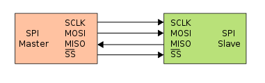

By definition it is not tri-stated. It has two states either an input or output state. Serial Peripheral Interface (SPI) is a Synchronous interface bus commonly used to send data between microcontrollers and small peripherals such as shift registers, sensors, and SD cards. SPI is a Synchronous transfer - That means that the clock signal accompanies the data signal. MOSI - Master Out Slave In; MISO - Master In Slave Out; SCK - Clock signal from master to slave; SS - Slave Select signal selects slave devices. SPI is a bus and can have multiple devices on the bus. It uses separate clock and data lines, along with a select line to choose the device you wish to talk to. As I see it if the chip is not selected the MISO becomes an input.The diagram shows the data flow when the Slave selected.
I don't agree here. It appears the MISO is an output only. If it were an input then it would not conflict with a currently selected device on the same bus, which unfortunately it does.
John
MISO is an output when it is in slave mode, when in master mode it is an input. Try this link: Serial Peripheral Interface (SPI) - SparkFun Learn
