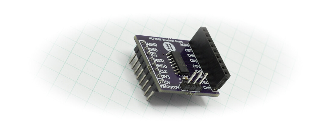

Does anybody have any experience of connecting an external ADC (like MCP3008) to Arduino over SPI using SPI built-in library?
The problem is:
When I manage SPI by hand (bit banging on the lines) the resulting ADC value for a sensor is correct and nearly to a single bit the same as the one from the on-board ADC (A0).
But, if I try to use the standard SPI library the resulting value is way different from the value of A0.
Here is the variant with .transfer(byte). .transfer(buffer, 3) gives the same result:

Kit: Arduino Uno, MCP3008.
