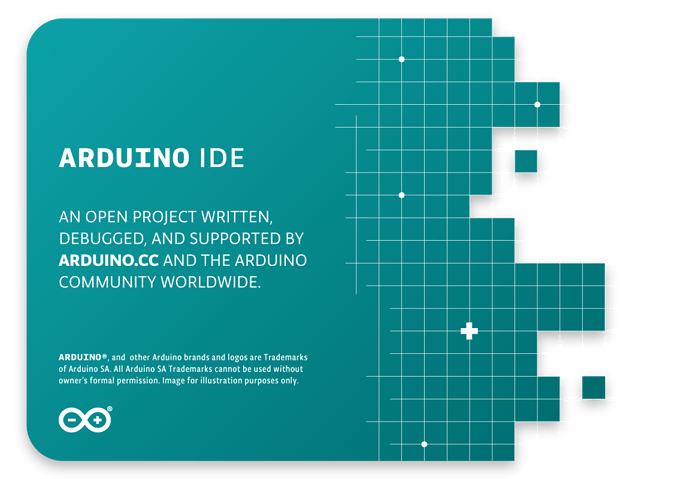

This just started happening today, after a couple days of using it with no issue. When I launch the IDE, the frame window with the menus appears, with the little turquoise splash screen in front of it. Normally that disappears after a few seconds. Today, I've tried it numerous times, and the splash screen no longer disappears even after several minutes. Although I'm able to execute menu commands, e.g. Help -> About, the splash screen obscures the help dialog.
@jmporter34, your topic has been moved to the dedicated section for IDE2.0 beta.
After you see the Arduino IDE window appear, do you see an error message displayed in a "toast" popup at the bottom right corner of the IDE window?
I do not, but if I resize the window, I see a "loading" swirling blue dots animation.
I am able to click on the menus. When I try and open a new sketch, nothing happens.
When I try and open a 1.8 sketch, it gives me the file explorer, but once I select the file, nothing happens.
I'm pretty sure that there were no error messages. I can't be 100% sure because it was over a week ago, and a couple days later I uninstalled 2.0 and reinstalled the 1.8 release.
Which operating system are you using @eric_luna?
I'm on windows 10. I just installed 2.0 a few days ago. I have 1.8 already installed, and it's still working fine.
