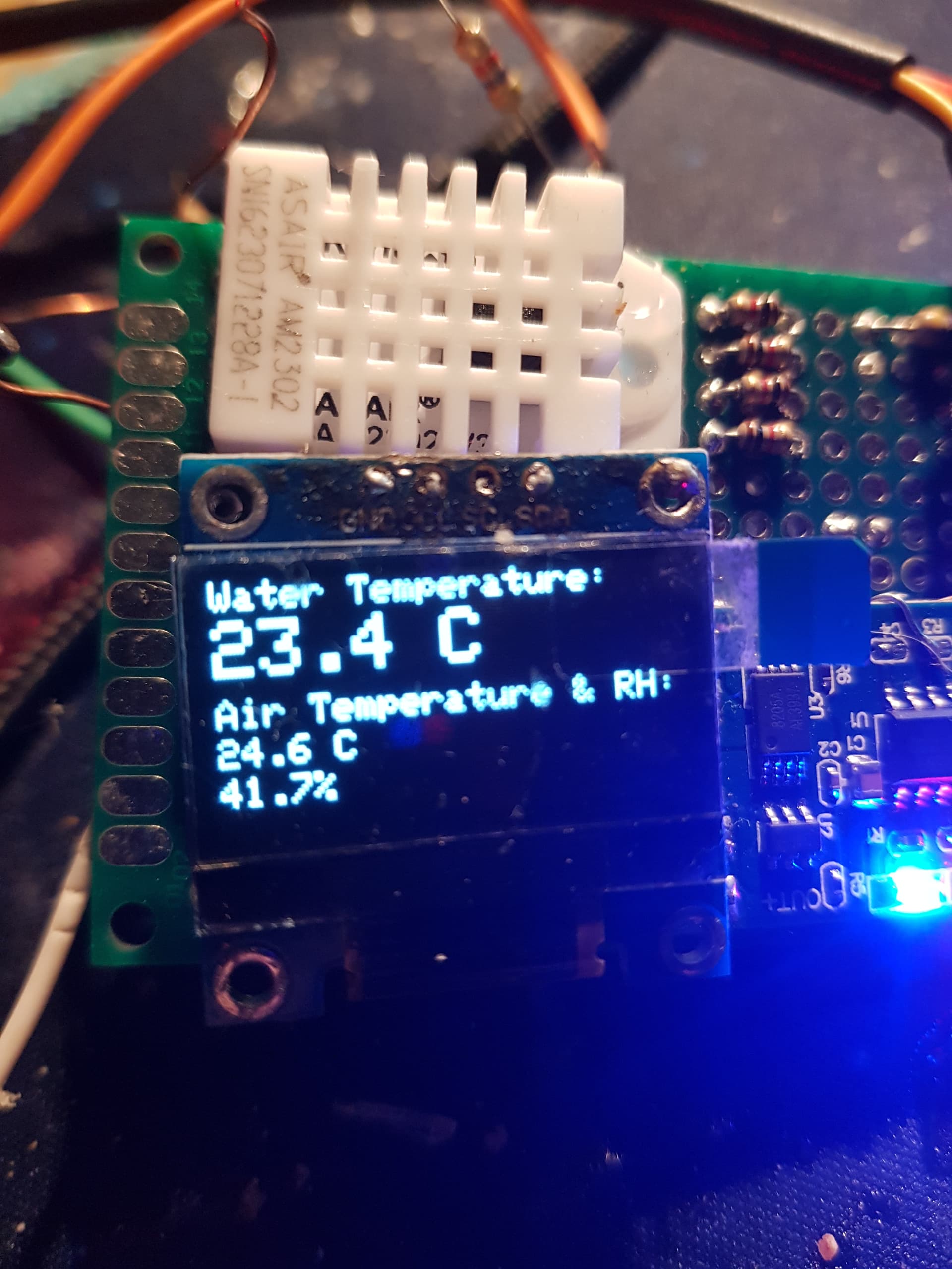

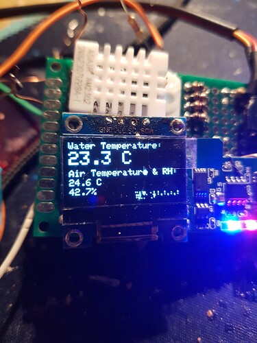

This is my SSD1306 oled it's showing trash pixels in the corner of the screen. Is there any way to fix it ?
The two pictures show that the screen stops showing the trash for a few seconds but then shows the trash.
Also the Adafruit (i am using Adafruit SSD1306 library) oled demo test example works fine. I've also noticed that the pixels on the corner change when other stuff updates on the screen , so i'm shure they are ASCII or other data forced on the screen.
Also here's the sketch :point_right:

You need to show your sketch. You want answers, not guesses.
Ok shure i'l do that now
If the dots change while the program is running, that is a sign of memory problems, like writing outside of array bounds, using String objects, etc.
DO NOT use Strings. They poke holes in memory and eventually cause AVR-based Arduinos to crash. Use C-strings (zero terminated character arrays) instead.
  String longText = "";
I would be very surprised if that code does anything at all other than use up CPU cycles. I don't see how it could possibly clear anything.
Hey there
had the same issue on (i believe) the same display. @jremington gave the proper hint, the issue is with memory (more specifically RAM vs. flash) usage.
my solution was to enclose all strings in my Serial.print()/println() and display.print()/println() calls with the F() macro - which keeps strings in flash. it does have some drawbacks tho, two identical f-macroed strings will end up in 2 instances of the string in flash, for example. i noticed in your code you did it in some places, not in others.
the F() macro is described halfway down PROGMEM - Arduino Reference
i can now use the display in 128x64 pixel resolution with the Adafruit_SSD1306 library without a garbled last line.
optionally you can use the absolutely powerful u8g2 library but it's a lot more complex, at least for my brain...
btw if you want to use the degree symbol: display.write((char)247); does it for me if i dont use the cp437 font.
hth
