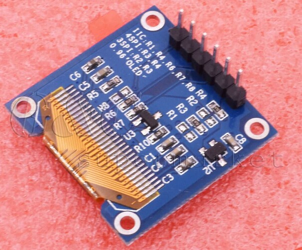

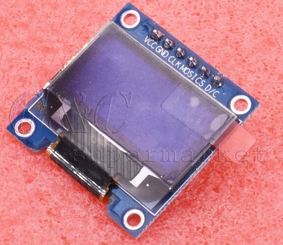

After searching through the internet I've found that:
The I2C versions that do not use the reset pin have an R-C network and one diode to force the reset pin at power on.
There are also SPI versions without reset pin and a built-in reset network (either R-C or a power supervisor IC), but they seem to be a lot less common, harder to find and have a different pinout:
