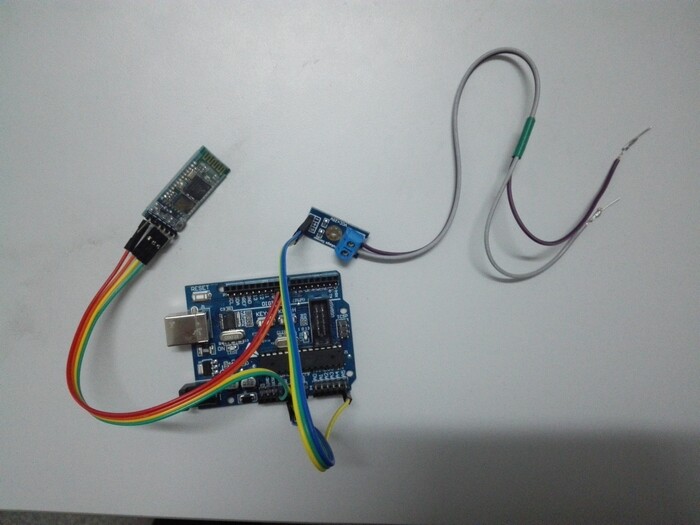

The project of B-OSC is consists of Arduino , Bluetooth module, voltage sensor and APP software.
The hardware of the project is as follows:
Arduino UNO;
Bluetooth module:HC-05;
Voltage sensor module(DIY by:7501=7.5k and 3002=30k resistors);
Dupont Lines。
- Schematic Diagram and Physical Map:
Fig.1 Schematic Diagram
Fig.2 Physical Map

4.Test
The test Waveform about 21V as Fig.3b).It is matched the theory waveform as Fig.4. The result is acceptable.

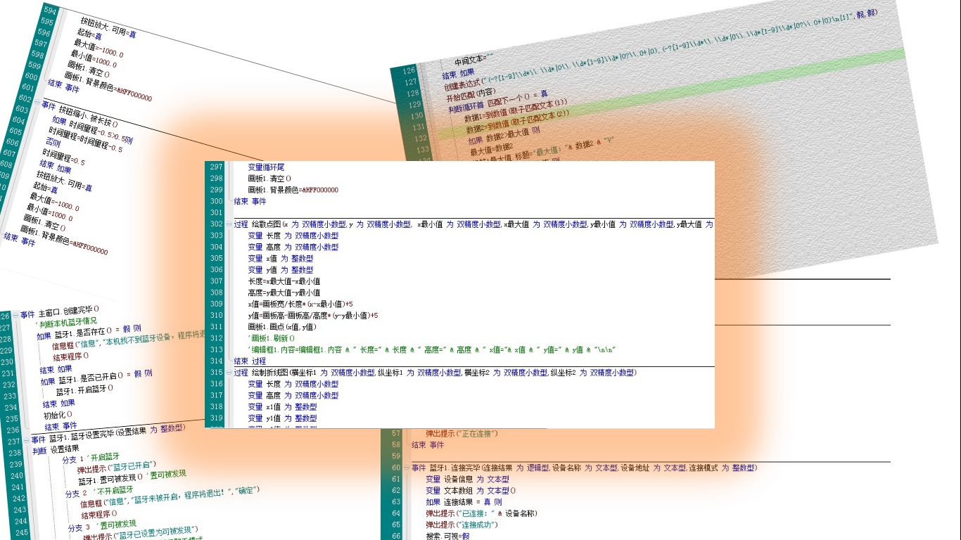

APP Source code:It is programmed by E4A and fit to Android System. Some as Fig.5.
Fig.5 Source Code

5.1 The programm of App programs is harder than UNO code, because we must convert the data from bytes to float value。
5.2 the App can draw all data like “,\n” such as Temperature.
