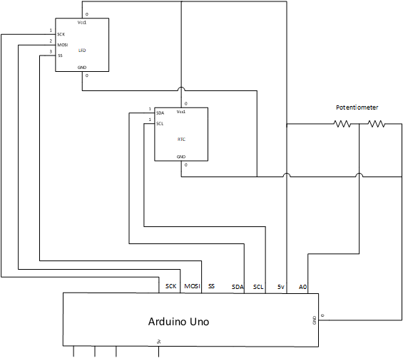

I've been building a digital clock using a standard 8x32 LED matrix and an RTC chip. I am looking at adding a potentiometer to the design to adjust LED intensity.
Basically the Arduino powers a breadboard power rail and the 3 components, LED, RTC, and potentiometer, are all connected to the rail in parallel.
The value read from the potentiometer varies constantly, which I guess is normal, especially since the current draw of the LED display is varying. (Current draw at the rail is typically around 140mA but often dips down signficantly.)
I can smooth this out in software, but I was wondering if there is a way to smooth it in the circuit itself. Specifically if the addition of a capacitor might do this, but I'm pretty vague on exactly how to use capacitors in a design.
Suggestions?

Can you post a circuit diagram please and a picture of your project so we can see your component layout?
How much does the raw data vary from the pot wiper?
I think this covers the schematic. As I said, all are parallel on the 5v/GND rail.
Thanks for the circuit diagram.
Try a cap as suggested by @CrossRoads.
How much do the raw data values of the analog input vary?

peterkwa:
So not using star-grounding or star-supply wiring - there's the issue. Separate wires all the way from the 5V and
ground pins are needed. This probably requires something like this: DIY: Y-Adapter Jumper Wire - Michael Schoeffler,
certainly for the 5V pin.
However a separate external 5V regulator to power the LEDs is perhaps a better approach.

"Eliminate pot variations, and add supply variations."
Yes right Leo, good point. I had assumed the OP would be meauring with respect to the internal reference which
(despite its limitations) is pretty well regulated from supply variation.
So a cap from the arduino's ground pin to A0 should improve matters - assuming the pot is connected to the same ground pin.
Generally schematics dont give a good indication of supply connection layout.
