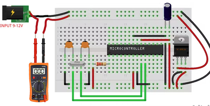

Oh, hi everyone. Hopefully a simple question here. My standalone ATmega 328p is drawing significantly more current than I anticipated. When the same chip is mounted on an arduino uno it pulls roughly 40mA. However, my "bare minimum" standalone set up draws 800mA.
Below is a diagram of the setup I'm using. Click here for the full project that I got the diagram from, although I'm not planning on completing the linked project. I'm just borrowing its standalone diagram.
Any guidance would be adored. Thankee.

Missing from your circuit are the two 0.1uF bypass caps, one from Vcc to ground and another from AVcc to ground. They are required and the 10uF bulk capacitance in no way makes up for them.
And the crystal is wired incorrectly. :roll_eyes:

I have the rest of the circuit in series with my meter. Like this:
If nothing is getting hot, then I suspect you are not getting a true reading.

If you have the wiring as indicated in the picture the crystal looks fine to me. Maybe @Paul_B can tell us what is wrong, I am sure missing it.

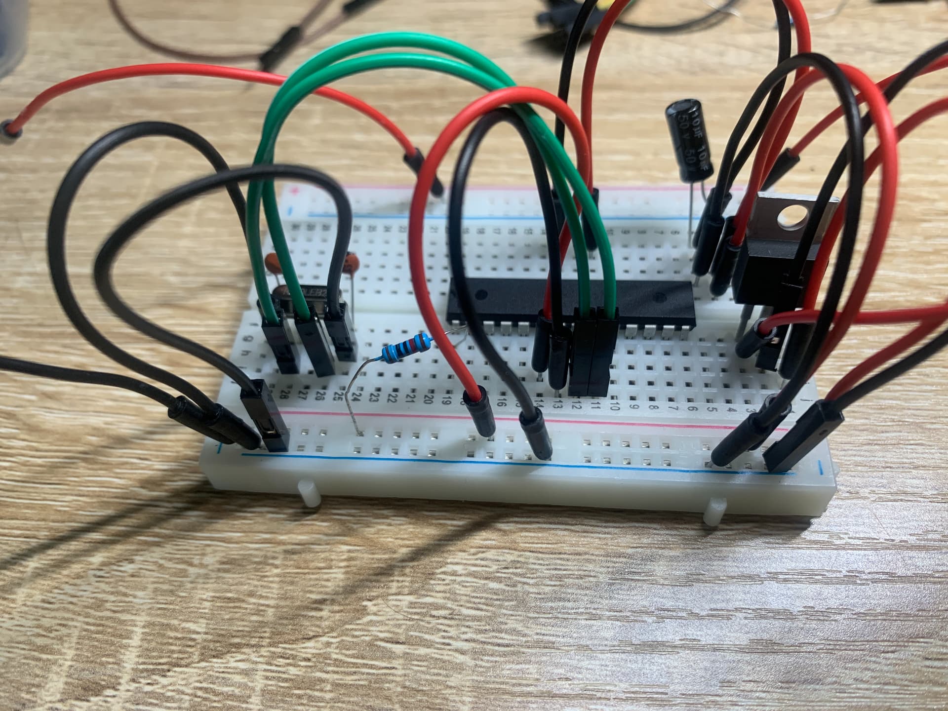

@groundFungus , here are the photos of my wiring. Perhaps not super helpful with all the jumper cables, so I took multiple angles:

Your photos don't show the 0.1uF (100nF) decoupling capacitors that were suggested by @groundFungus back in post #3. The regulator (7805?) usually has capacitors between Vin & Gnd and Vout & Gnd as well.
Edit: Do you have another Arduino board to hand - maybe an Uno, that you could take 5v from to temporarily power your breadboard project and get the simple blink sketch working. Remove the regulator from your breadboard first.

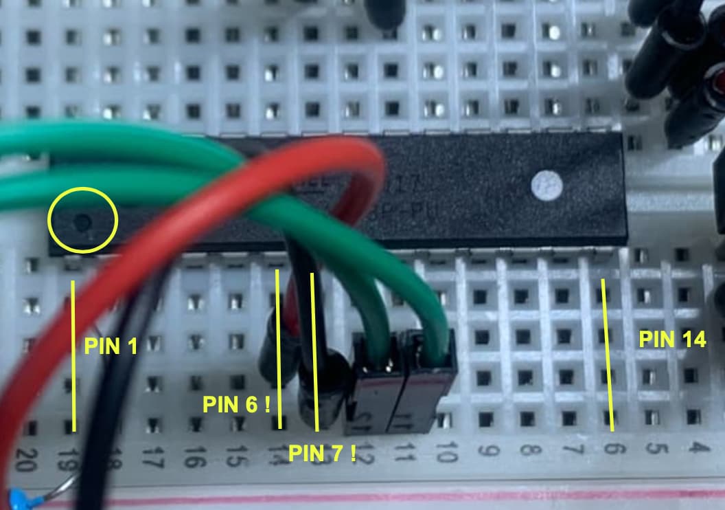

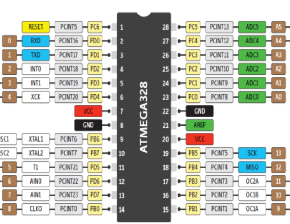

The photos help. You are indeed shorting out the power supply !
In the image below, you can see that +5v should go to pin 7, GND goes to pin 8.
In your set up you are out by 1 pin. You have +5v going to pin 6, GND to pin 7 !!!
The crystal is also on the wrong pins.
... probably should have checked one more time !
