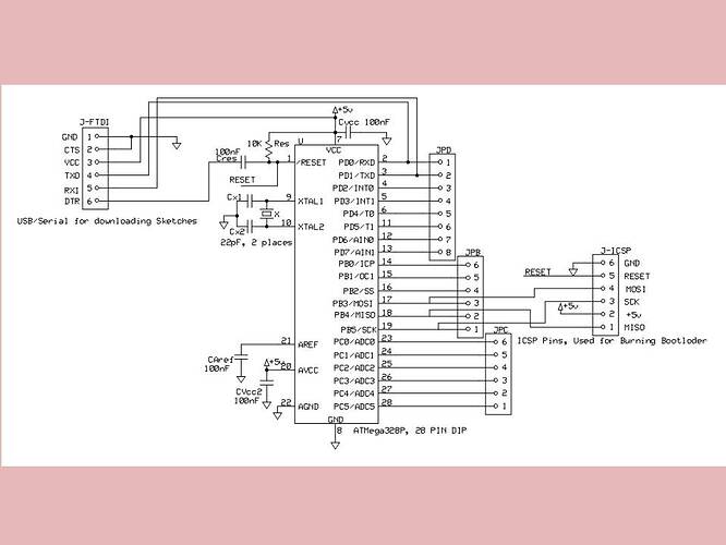

Electrically, you don't need much connected to burn a bootloader or download a sketch.
10K pullup resistor, crystal, 2 22pF caps, couple of 100nF power supply caps.
If going to do a lot of bootloader downloading, then adding in a connector for an AVR ISP programmer becomes convenient. Otherwise can just jumper to the needed pins once.
If going to do a lot sketch downloading, then adding in a connector for an USB/Serial adapter (such as FTDI Basic) and a cap from DTR to the reset line also becomes convenient.
After that, add connectors as needed.
Or just wire up additonal components as needed. Here inthe lower left hand corner I have a ATMega328, crystal, 22pF caps, and 3 100nF caps, 10K pullup is in the socket above the uC.
No headers for downloading sketch or bootloader - the chip was preprogrammed and just plugged in.

If you have a Duemilanove, you can add 4 pins to the X3 connector and then use the FTDI chip to download bootloaders:
http://www.geocities.jp/arduino_diecimila/bootloader/index_en.html
Or spend $12-14 and get an AVR ISP for downloading bootloaders.
You do plan on doing more than 1 project, yes?
Then one of these options would be a handy tool to have.
