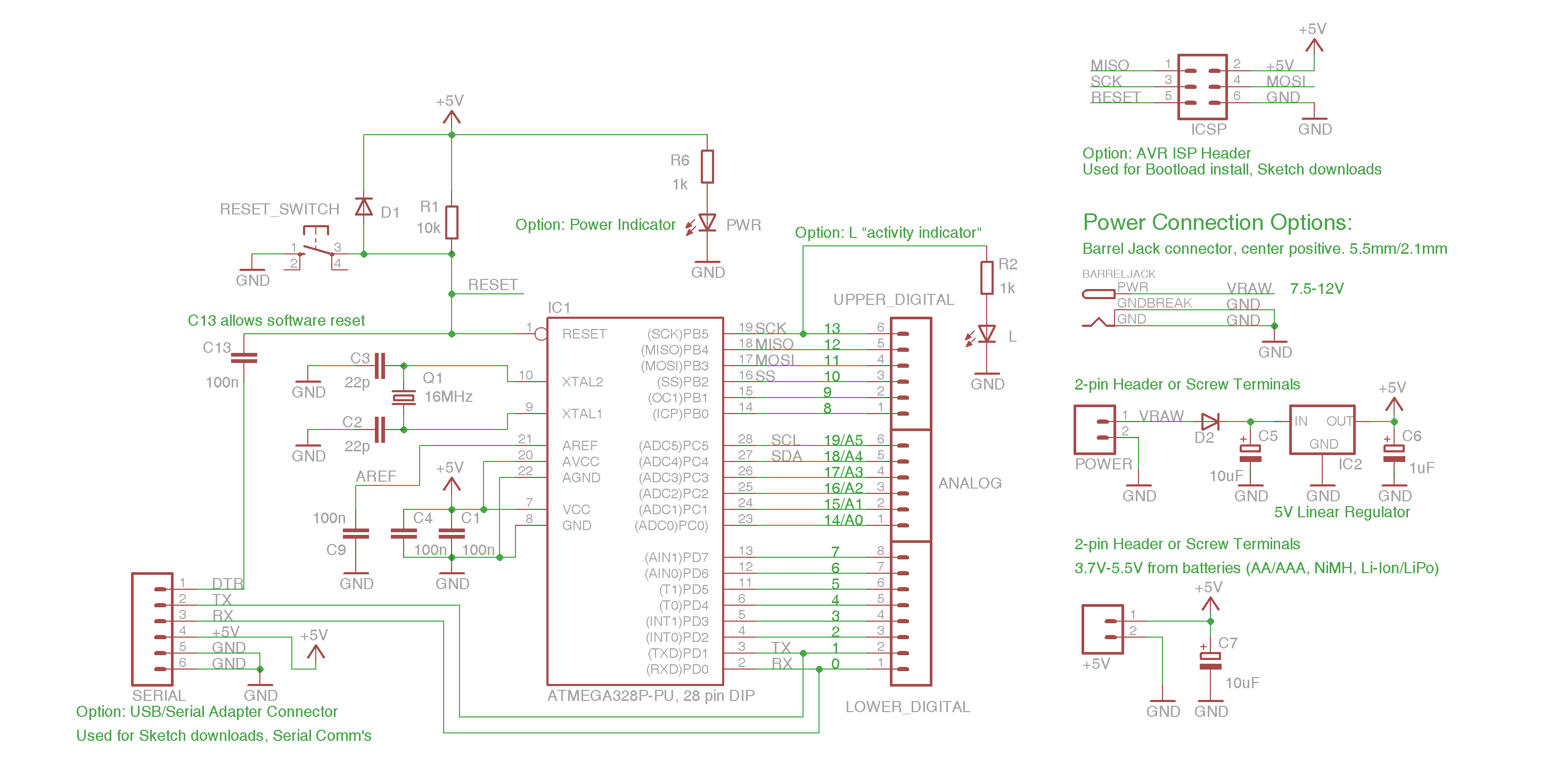

Here’s a schematic showing the minimal connections and options for connecting up other nice to have stuff.

Are you talking to me? I have VCC, AVCC, and AREF all connected to +V. On the top side I have one line going from +5 to AREF and AVCC, it's just joined by solder under the board. Yeah, I should probably have an extra cap up there.

You have AVCC connected to +5 also? I put decoupling caps on both pins.
Are you talking to me? I have VCC, AVCC, and AREF all connected to +V. On the top side I have one line going from +5 to AREF and AVCC, it’s just joined by solder under the board. Yeah, I should probably have an extra cap up there.
No need to have +5 wired to Aref pin, leave it disconnected and maybe bypass it to ground with a .1ufd cap. The default ADC reference voltage is derived from whatever voltage is on Avcc. See all the standard Arduino boards where Aref is just wired to a shield pin so that if one wishes to use an external voltage (1.0 min to Vcc max) and then issue a external reference command for the ADC. Wiring a full time +5vdc to Aref would prevent you from ever selecting the internal 1.1vdc reference because damage would result.
Lefty
Aref should not be connected to Vcc. The chip makes that connection internally, or to 1.1V if that is used. Aref only needs a 0.1uF cap to gnd. Vcc, Avcc should each have a cap.

Back to Aref, as I see a question in my e-mail that hasn't shown up here:
From the '328 datasheet:
"Internal reference voltages of nominally 1.1V or AVCC are provided On-chip. The voltage reference may be externally decoupled at the AREF pin by a capacitor for better noise performance."
"The ADC converts an analog input voltage to a 10-bit digital value through successive approximation. The minimum value represents GND and the maximum value represents the voltage on the AREF pin minus 1 LSB. Optionally, AVCC or an internal 1.1V reference voltage may be connected to the AREF pin by writing to the REFSn bits in the ADMUX Register. The internal voltage reference may thus be decoupled by an external capacitor at the AREF pin to improve noise immunity."
And from "Atmel AVR042: AVR Hardware Design Considerations":
"To be able to obtain good accuracy with the ADC the analog supply voltage must be decoupled separately, in the same manner as the digital supply voltage. AREF must also be decoupled, a typical value for the capacitor is 100nF."
Thus connecting to 5V externally is not required, only a 0.1uF cap to Gnd is needed.
CrossRoads: Thus connecting to 5V externally is not required, only a 0.1uF cap to Gnd is needed.
...but only if you're using the ADC, and need maximum accuracy.
